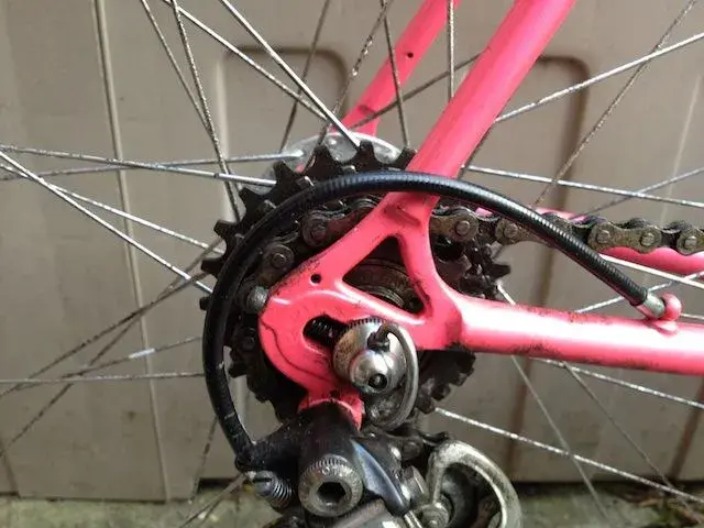

'scuses for being an ignoramus but why do racing frames have that little hole on the rear dropout.

You'll notice on close inspection its a threaded hole, thats if its not rusted to death!
Rear drop-out adjusters go in them so you can set your wheel up accurately :wink:

Thanks for that Ian but it was this little hole that I was interested in.

Portecena (spelling)...... chain hanging device for when the rear wheel is out :)

Wow, Posh!
Don't have a picture do you?
Or is it just a type of rusty nail poked through the hole?

http://campagnolo.wikispaces.com/Portacatena

Well thanks, that clears that up.

Well bugger me thats a new one on me! My last device for holding the chain in place without the wheel fitted was a bare hub !

After reading the link Shaun put up i now understand what that 'thing' is for :shock:
The Portacatena was introduced at the '77 Milan show, and made it's first catalog appearance in 1979.
Used with a version of Campagnolo's 1010B dropout taped with two screw holes, the portacatena consisted
of an aluminum rail that attaches to the inside of the dropout, and a special rear shift lever. The idea is for you
to replace your 6 speed cassette with a 5, the aluminum rail attached to the inside of the dropout takes the place of
the 6th cog. In the advent of a puncture you shift over to thee rail which should hold the chain out of the way and
make for speedy wheel removal. When I install my portacatena, I'll add more detailed photos of it on the bike and in
action as well as a better description of it's function.
