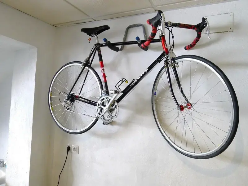

pps. I attached a few pics of my other bikes, hope that is ok.

Nice bikes, especially your black Joe Waugh. It's rare to see splatter bar-tape look so good!
