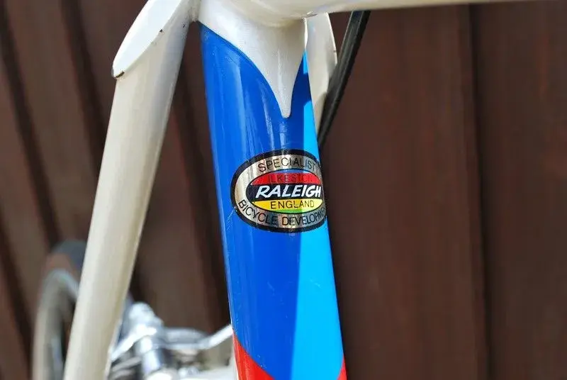

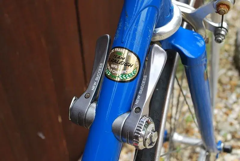

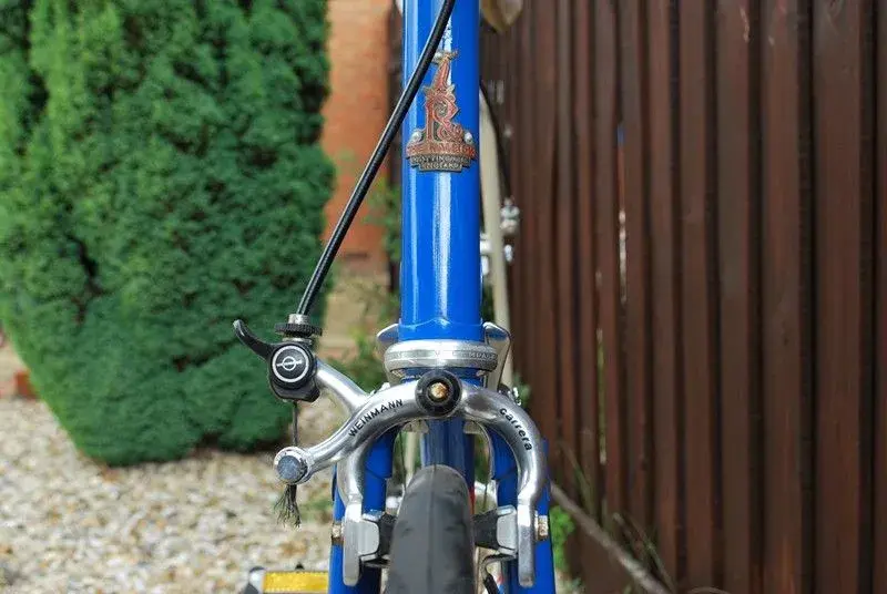

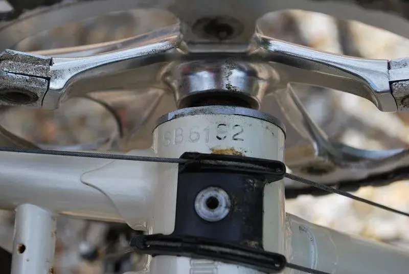

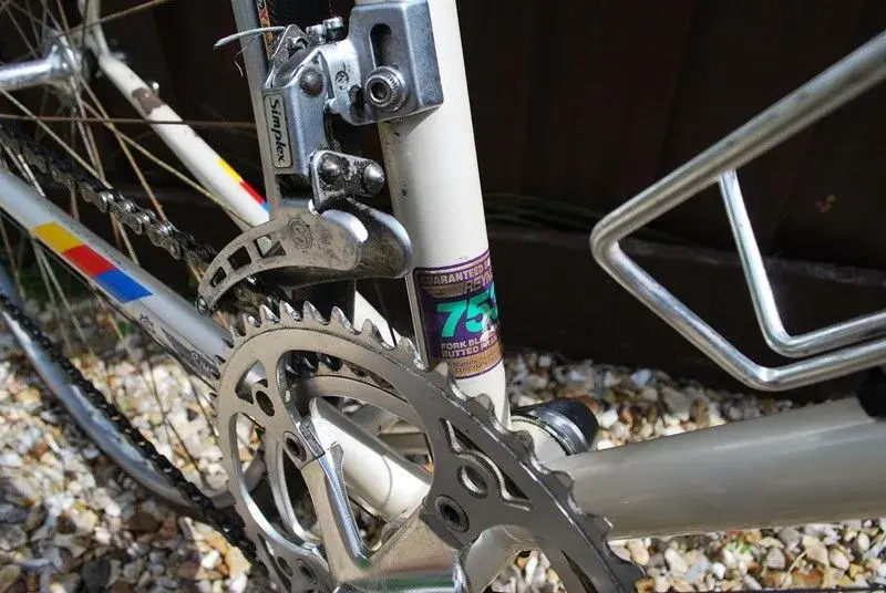

I have recently found this Raleigh road bike in the roof of my girlfriends dads workshop. I showed a friend and he loved it and he recommended that I ask and try and find out abit more about it as it appears to be an interesting spec. I have tried to do a little research into dating the bike but been unsuccessful as I don't understand the serial number dating.
It would be great if anybody can let me no anything about the bike !! I'm looking forward to getting it back on the road.
Many thanks

The standard Raleigh dating system won't work with that bike as it's a SBDU bike. This means that the numbers don't really correspond to any date (not like the other Raleigh/carlton serial numbers that have the month and year coded into their serial number. SBDU bikes start SB then have 4 characters, which are sequential.
You might find some more info here:
http://groups.yahoo.com/group/TI_RALEIGH_TEAM_PROS/
Nice bike BTW!

That's a really odd spec, strange that it's got mudguard eyes, funny front mech braze on etc. Maybe this is a one off order done for a specific customer? The SB frame number will help you pin down an approx date of manufacture if you register with the Yahoo forum - they have a big database of users bikes.

Looks a very nice 753 frame with a mish-mash bag of wrong parts put on it :oops:
Having eyelets on the forks and rear drop-outs suggests a bit of a touring frame but thats just me :roll:

Nutted brakes, Simplex dropouts, mudguard eyes, French style front mech braze on....then the 753 sticker comes as a bit of a shock.
I agree, probably a custom built frame for someone.

The frame number is also past my era, in the late 70's they were 2000 ish plus, that number certainly puts it in the mid 80's at a guess.
Seat cluster with the plates being wider than the stays is typical of the frames I came across in the 70's..........later models in panasonic colours seemed to be fastback. SBDU frames not my area of expertise and RoadKing knows more.
