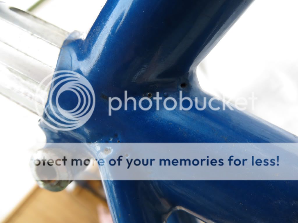

I did notice these tiny pits in the weld joint at the junction of the seat tube, chain stays and top tube and was wondering whether they are significant in the short or long term - or nothing to really worry about ? A close look suggests the holes may be contemporary with the build as some have original paint over/inside them......

And here's the photo showing the small pores in the weld that I mentioned above Image

It wouldn't concern me, it just looks like slightly sloppy welding.

"sloppy" is an understatement LOL Shouldn't be corroded (take out seat tube) I'd fill and use a bit of nail varnish to cover :D

Yeah I was a bit surprised to see this poor quality weld given his reputation in Italy and it made me question whether it was an original Stelbel. I've posted up on a couple of Italian vintage forums and they seem convinced it's genuine though. Looks like the weld got too hot and started to melt the frame :shock:
