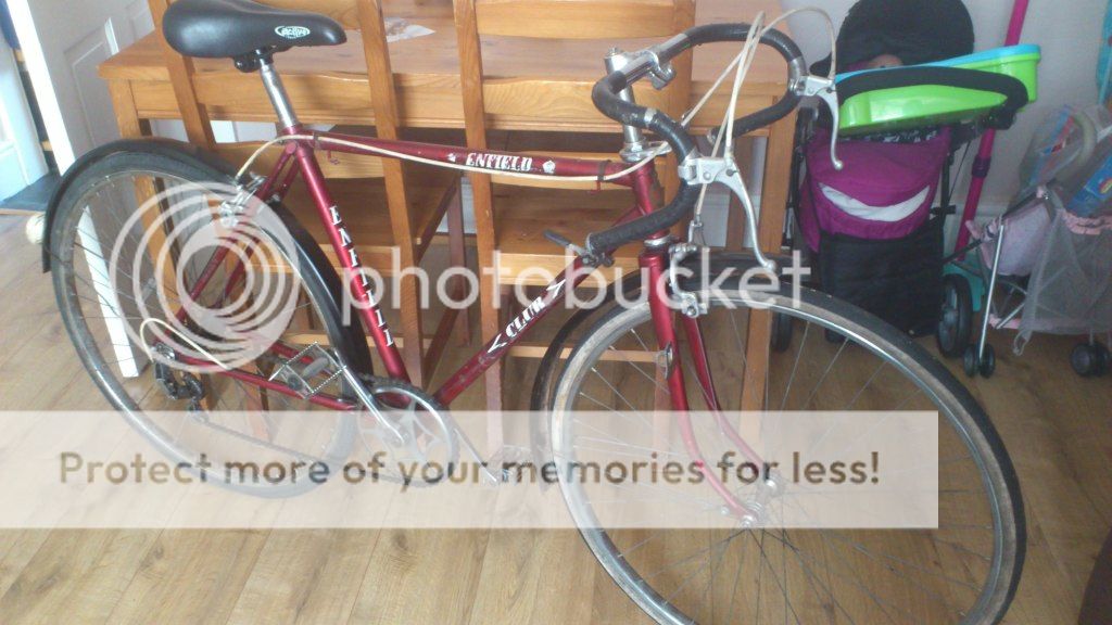

Following on from a previous post i picked up my first project tonight a royal enfield club. I know its not much but it looks like it will tidy up well the only bits i am planning to change are the wheels.
I'm guessing its 70's but what shocked me was (bear in mind im a newby) the components make match my old Raleigh burner like for like brake hubs even reflector were the run by Raleigh at some point? Anyway here is the spec and pics oh and a few more questions :roll:
Weinmann brakes levers stamped 22 730 front brake and 810 rear
rigida superchromex rims (beyond repair i think) weco r/hub atom front
MAEDA cassete

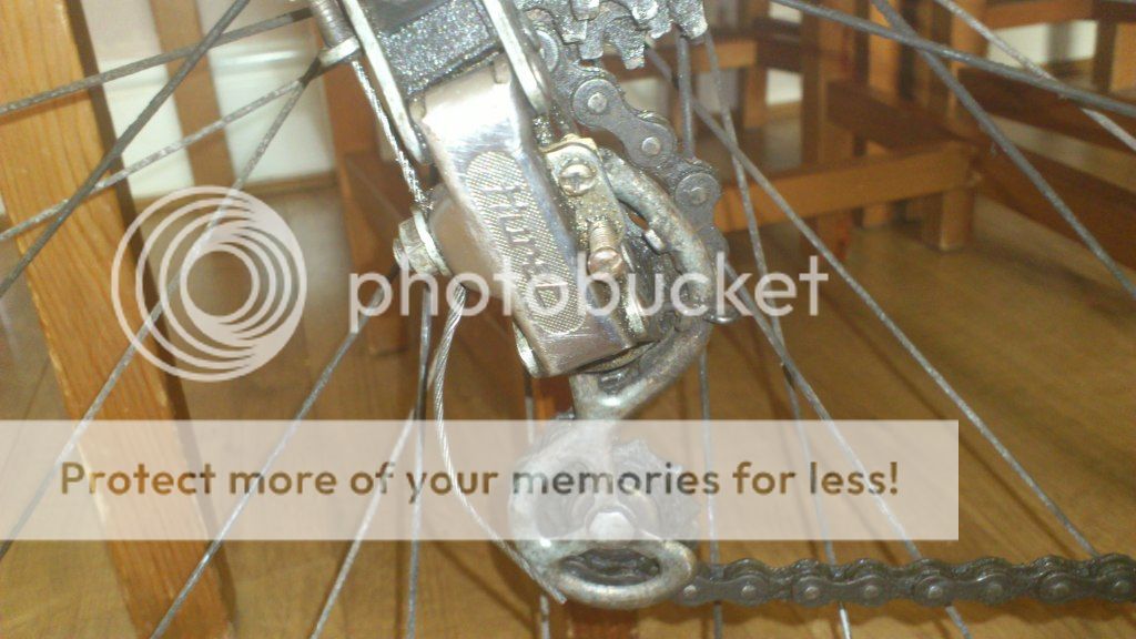

5 speed Huret gears
The bike :lol: looks pretty origional bar the seat and repaint i bought it knowing it could be too small maybe even a junior model but with my feet flat on the floor my nads are on the crossbar best way i can explain it :oops:

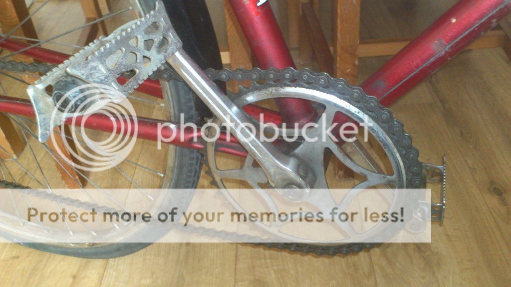

Cant find any marking on crank chain wheel or pedals so unkown although the pedals strip down so hopefully i can service em?

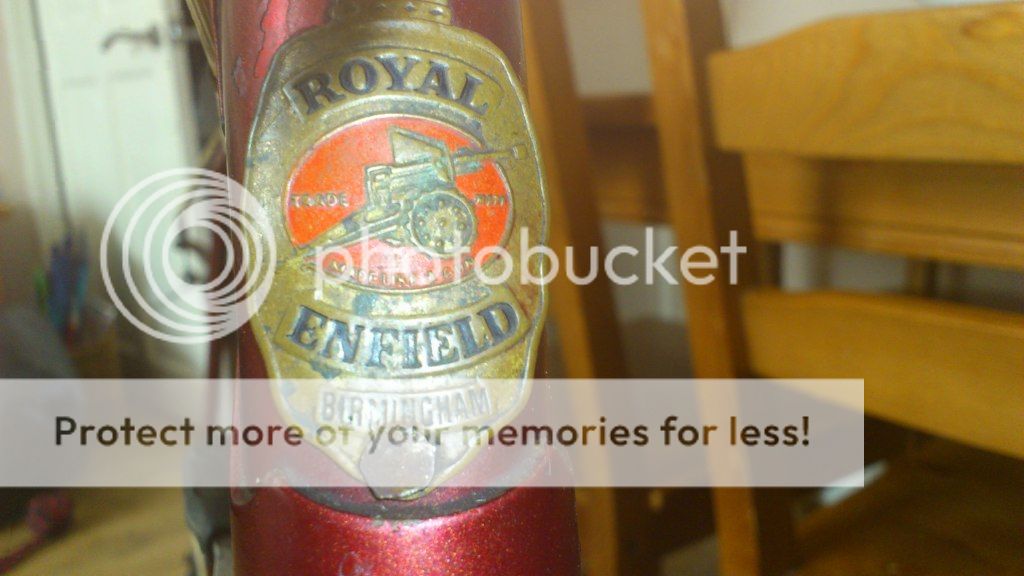

I know its not up to much but for some reason i like this little bike even the badge is cool

Well i know no one is probably interested :oops: but i found a serial number on the frame which was made by Raleigh in Notingham Oct 76 so i pressume it's badged incorrectly or they were bought out by Raleigh.

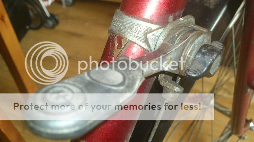

The non-aero brake levers, hard rubber tipped shifter and that Huret derailleur point to late 70's. Not sure the saddle belongs with it, but the rest looks pretty original. By the mid 80's, shifters tended to be brazed onto the frame rather than band-on.

Cheers after a fair bit of googling looks like its a re-branded Raleigh Olympus even right color. Managed to get a NOS rear wheel so all i need now are tyres :D
