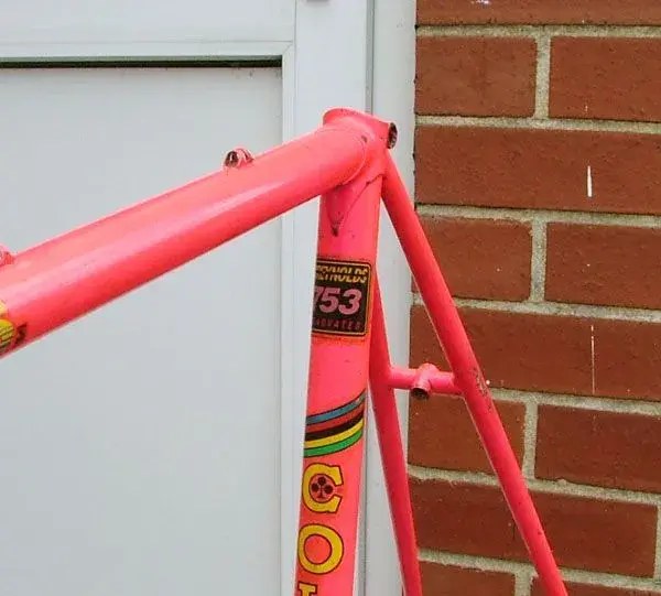

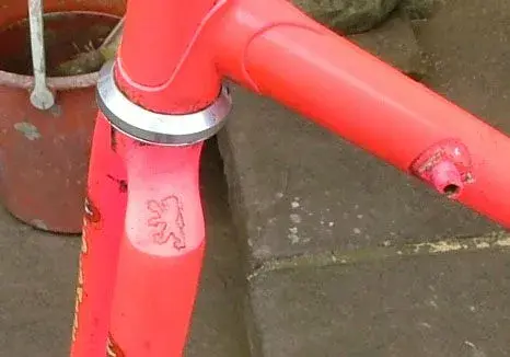

Some genuine Pug 753 details here (even if it does say Colnago it is a Pug!) It also was resprayed in the 80's as can be seen by the faded fluo colour scheme!
