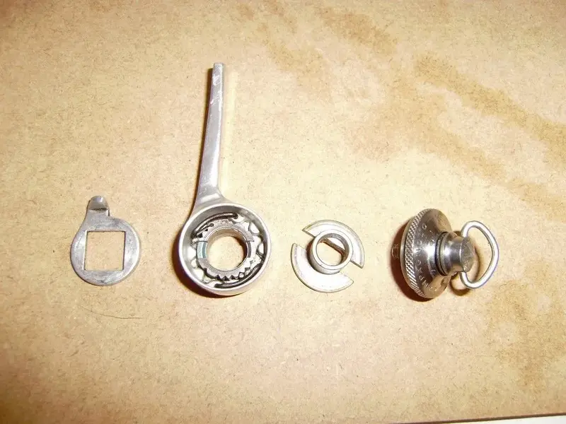

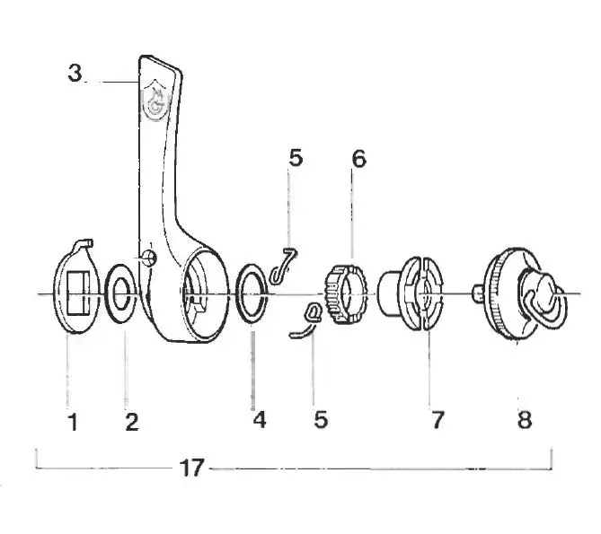

Bought these recently off a member...with probably some missing parts.
It looks like the only part I need 7300178 'bracket washer', number 2 in the picture.
Anyone help me find one of these...
Tvm.

Right now I have 2 Synchro levers...1 standard cable pull, the other is a 'long pull' type.
I also have 4 'index rings' to choose from, 3 are 7 speed and 1 is an 8 speed...so i'm hoping to get something to work!

Sadly, I have everything apart from that washer. I think any washer roughly the right size should work ok, given that it is an index lever rather than friction.
What mech are you planning to use? The 7 (and 6) speed index rings work in the standard pull levers with the old rear mechs (Super/Nuovo Record, Nuovo Gran Sport, early Athena/Chorus/Record), but not with the 8 speed rear mechs, which are set up to work with the 'long pull' levers. I've only tried the latter with the 8 speed index rings.
