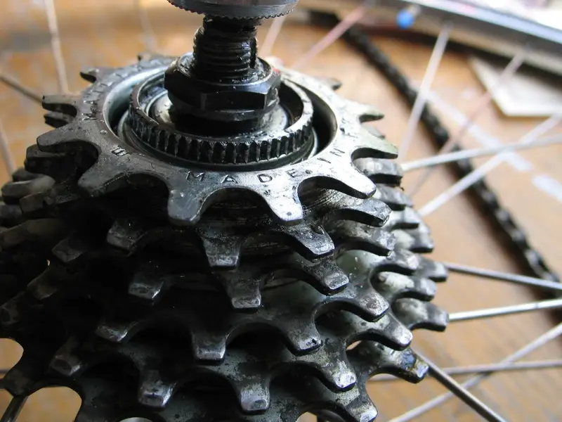

thanks very much you chaps. That's very kind. I'll get cracking and let you know how I get on. Think the cassette locknut tool might be a problem. I've added a pic of it. Thanks again
A Helicomatic?

Helicomatic - yes. Thanks. The hub sticker reads: "Helicomatic Sealed System". And thanks for the interesting link and the image of the lockring removal tool.

blastee wrote:
Helicomatic - yes...
In which case, please ignore me!
For an alternative viewpoint - Sheldon Brown on Helicomatic hubs.
