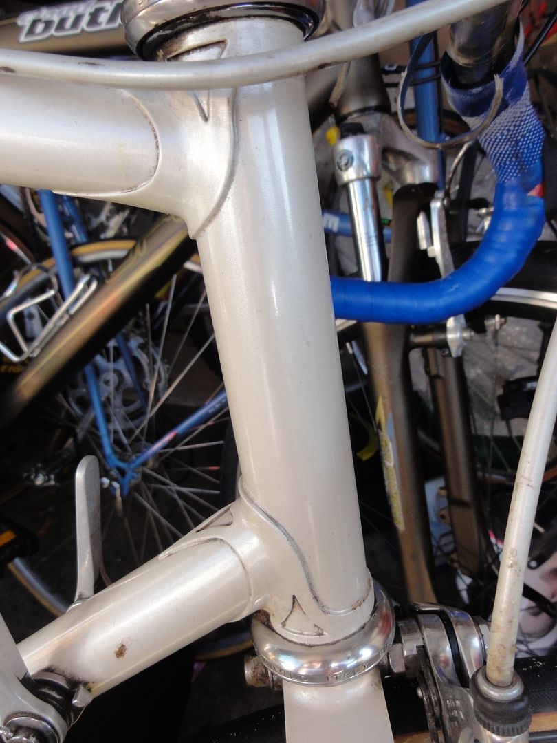

Just got this gem off ebay although would love to know more about it.
Sellers text

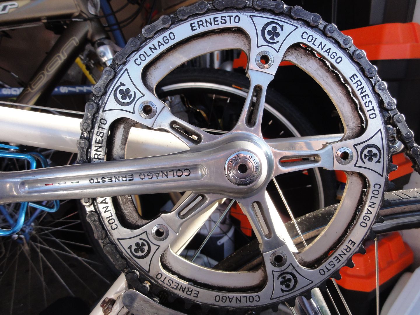

1980s road bike. Very light Reynolds 753 frame( 23.5") and forks, pearl white; chromed chainstay and drop-outs; Rare Ernesto Colnago chainset with original stencil cuts ( equivalent to Campagnolo Super Record); Mavic Open 4CD rims on Mavic hubs; Brazed on front changer ( Campag); Mavic rear mech and tri-bars; Campag headset, bottom bracket, and downtube levers (inscribed); Look Carbon pedals; Shimano 105 brakes; Cinelli bars; Iscaselle titanium saddle.
Virtually all components top of range ( except brakes?!) - set up as time trial bike - rear sprockets 13-21, front 53/49, and long pedal cranks ( 172.5 mm

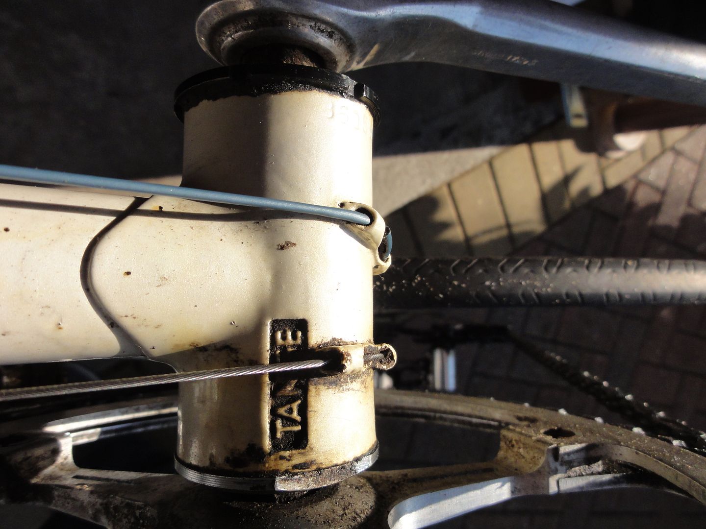

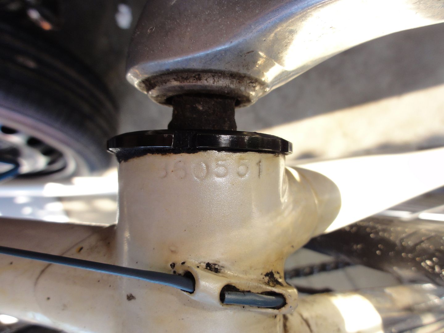

Frame no is 360551 and has 'Tange' written underneath on Bottom Bracket

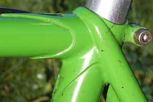

I had a look on the Classis Lightweights site and it does have the same brazing like the green frame featured.
Any help greatly appreciated

Very, very, very nice pantographed Chainset! :)
It seems a bit odd to have 'Tange' on the frame. Tange is the Japanese tubing and frame manufacturer. Can you upload a pic?

I take it that you are referring to the cutout on the seat lug when you say it is the same as the Knight. This is a standard Prugnat or similar lug set used by most builders around that time and doesn't indicate the builder, sorry. It is a nice looking frame but there isn't anything specific that, to me, points to a definite builder. I'm also not sure whether Knight ever built in 753 - but perhaps they did.
Some interesting components on it especially that chainset. Give it a good clean and polish and get riding!
