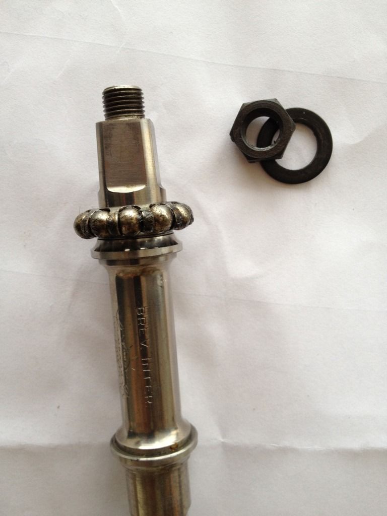

What races do I need for this axle? it's a second gen titanium super record type. The ball race shown is genuine & from a standard steel SR/NR axle but doesn't fit.
Help appreciated!

If it's hollow axle and Ti does that not make it 1st Gen. SR?
http://velobase.com/ViewComponent.aspx?ID=0B5F8F7D-0425-4679-B3E1-38B991D50FF3&Enum=119&AbsPos=10
So would be 3/16" bearings rather than 1/4"
Hope that helps.
This is also useful... http://www.minortriad.com/campagbb.html

Thanks for the info. The velobase link shows the first gen hollow ti axle which was prone to snapping. My one is the second gen ti solid ti one with a threaded end and nuts. The second link shows my axle so your info on the bearings should sort it.
Cheers, Shawn.
