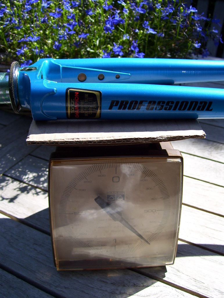

Me again
So I weighed two #2 forks:
one fork with aero crown
one fork with flat crown
both are chromed, both are for a 59 frame
both forks have a weight of 780 gram (incl race)

A Tange #1 fork I weighed about a year ago. 760 gram. Fully chromed, with race, for 58cm frame.
