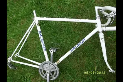

 Post subject: Photo
PostPosted: Sat Jun 16, 2012 11:15 am
Joined: Fri Jun 15, 2012 11:01 pm
Posts: 22
Location: High Wycombe
Heres a photo of the bike
PostPosted: Sat Jun 16, 2012 11:39 am
Joined: Wed Nov 24, 2010 4:38 pm
Posts: 1492
Location: The Lovely Lincolnshire Wolds and by the sea in Sussex
You should be able to source appropriate Shimano or Suntour front and rear mechanisms for sensible money and wheels too.
Ditto gear levers.
Just make sure your rear wheel is suitable for the width of the frame - measure between the rear dropouts (slots where the axle goes), which determines the wheel/hub width - I guess it'll be either 120mm or 125mm.
Weinmann brakes would be fine, they're good brakes but aren't regarded as"sexy"so are easily and cheaply bought - many vintage bike components are overlooked because of snobbery.
Have a trawl through ebay to get some ideas, then put a wants ad on here - there will be plenty of help.
Roadking.

PostPosted: Sat Jun 16, 2012 5:34 pm
Posts: 22
Do you mean the shimano 105s?
Also any advise on good reliable (but cheapish) wheels. Depending on the frame width.
PostPosted: Sat Jun 16, 2012 5:47 pm
Posts: 1492
Yes, a 105 rear mech will handle a 5 or 6 speed block/freewheel - 5 or 6 will be determned by width, which you have not specified.
Wheels are up to you, I don't know wether the bike was built for 27s or 700s...you need q/r clincher rims and your choice is based on your budget.
Try looking the bike up in an online catalogue for factory specs.
Rk.

PostPosted: Tue Nov 27, 2012 6:55 pm
King of the Skip Monkeys
Joined: Wed Nov 07, 2007 4:34 pm
Posts: 26499
Location: Moomin Valley
That frame would have come with 700c wheels and it will take a 130mm back wheel without too much bother.
I wouldnt go too mad but there is plenty of 'stuff' that will fit. Brakes will be nutted as opposed to recessed allen bolts. Dual pivots can still be bought like this.
Enjoy it!
