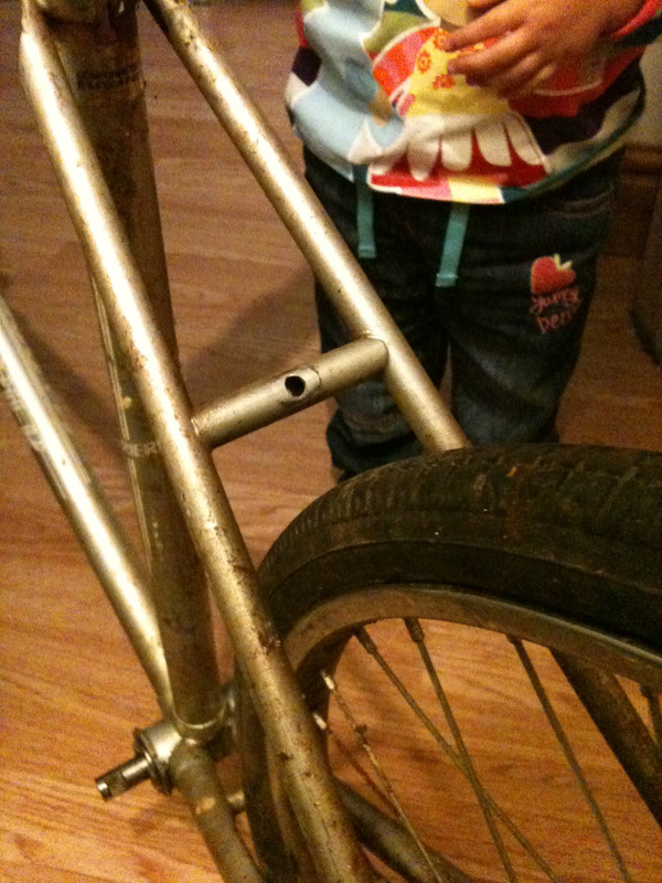

Here's a pic of the frame with the 24" rear wheel on, it looks like there's enough space for a 26" which is why I'm asking. :D
I'd love to restore this bike as it holds a lot of sentimental value to me, if 26" wheels aren't an option, I'm just gonna have to play around with the handlbar/seat positions till it's rideable :)

The only thing to do is try it! You'll need different brakes, mind (a good opportunity to upgrade them).
With a long seatpost it might fit you, but the saddle-bar drop will likely be quite large.

MTB wheels (559mm dia) typically come up as around 24.5" diameter with 1.2" tyres, so hopefully you can get them to fit. As said before, it's one to try and see if you can get away with.
You will have to consider getting the rear hub to fit - no doubt it has 126mm or even 120mm rear spacing. A road 130mm hub is probably simplest, but could well mean a custom wheel build.
