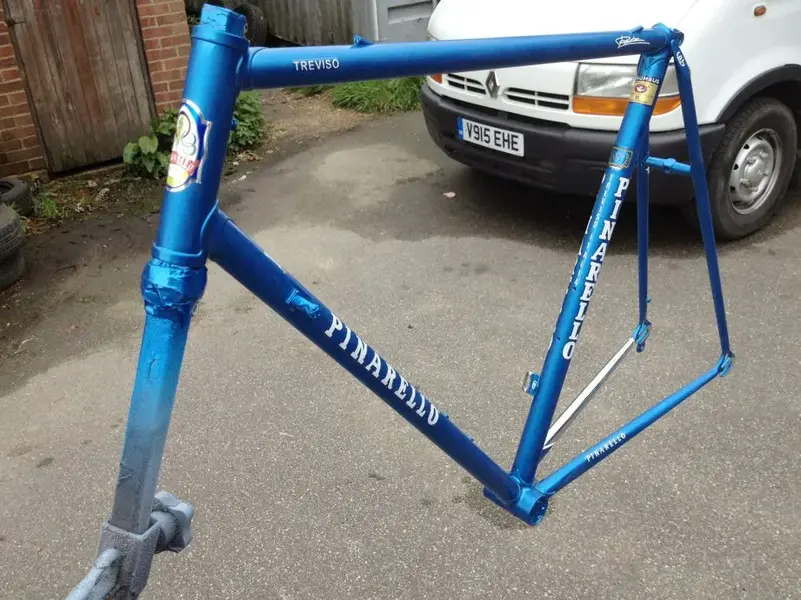

I am nearing completion of my early 90's Pina restoration and wondered if there may be some advise out there on a few things that I need to find in order to complete the project?

Some pics attached from the painter who is just waiting for a replacement decal and then it will be lacquered.
Cheers!
