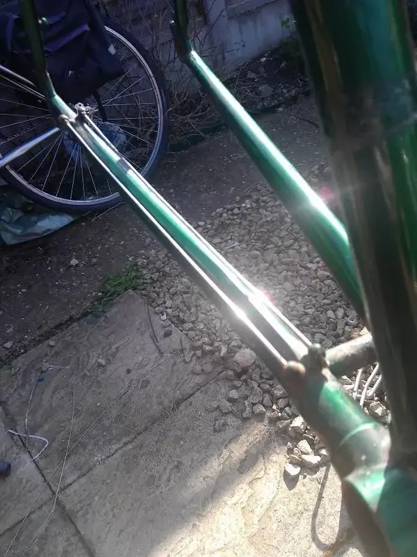

After spending last year restoring a Raleigh RRA (and not wanting to modernize it as turned out to be all original) I've picked up another project.
I've wanted one for a while, after spending a summer riding a Dawes Galaxy and loving it, I've finally picked up a Raleigh Randonneur off ebay.
I've taken a bit of a punt, as the frame has been resprayed so difficult to be certain it was definitely a rando', but I emailed the guy and he seemed genuine and he sent me the pic's of chain stay which I requested showing the spare spokes attached. reason for the respray was that it's been ridden all over the world so has seen some mileage, most parts have been replaced at some point.
I've attached some pic's, comments welcome as to if the frame is definitely a rando 531, it certainly feels light enough.

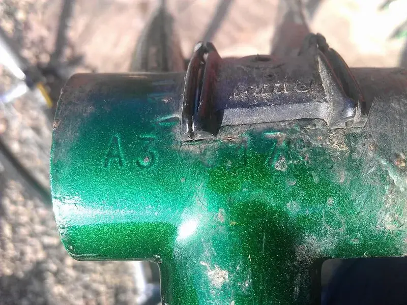

Only thing I'm not sure about is the serial number, doesn't seem to match any of the info found on the web, it starts with an A??? photo attached. the seller thinks it was about '88 he bought it new.
Anyway, not overly keen on green paint job, might go with the original two tone for the respray but will be cheaper to pick a single colour.
I've already stripped it down just need to choose a resprayer now.

Was wondering if anyone knowledgeable about Raleighs numbering system could comment on this one, really curious about it as I thought the lightweights had numbers starting with W denoting Worksop and later Nottingham. Any ideas?

retro-rich wrote:
Bump - :)
I am pretty familiar with the systems used both in the LU and in the SBDU, this Randonneur is a conundrum - I thought they were made in the Lightweight Unit, but it appears not as they would have the W prefix to the frame number.
The Randonneur is a second half of the 80s bike.
Could it be a misbuild with the chainstay mounted spoke carriers but be a Granada or one of the more"cooking"frames - unless anyone knows better(I'll check in my brochure collection).
Looks worth a resto though.

retro-rich wrote:
Hi Roadking
Thanks for the reply.I've had a look around the web, only other similar frame I can find is the Royal with canti brakes, so a possibilty. What do you mean by 'cooking' frame? a duff? If I can't be certain of its model, I'd feel a bit daft respraying and logo'd as a Rando, so if it can't be solved I may just spray a nice single colour with just the raleigh logo and enjoy it for what it is. Whichever way I'm positive it's a 531 as comparing it to this guys restore all the bridges etc look the same
http://www.flickr.com/photos/jwright/5090333140/
CheersRich
Hi Rich.
I certainly didn't mean it was a"duff", I use the term"cooking"to mean a lesser frame than the Rando'.
It is clearly a pretty good one as it has the R logo on the seat stay caps.
Either way, repaint it as a Raleigh and enjoy it.
Let's see it when restored and built up - good luck.
Rk.

FYI - I had a 1991 Raleigh Randonneur and it too had a serial number beginning with A. Think it was A0 to be precise.
