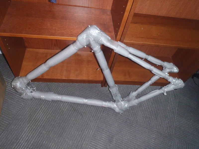

it was suggested that i start a build thread for my newly acquired colnago master olympic.
i bought it without seeing it, so was very pleased when it showed up all nicely wrapped up for it's journey from holland to singapore
the frame came as frame alone, so no forks or other components so i have a blank canvas to start with.
i'm not sure what year it is, but some input from some of you helpful chaps has narrowed it down to early '90's. 1992 perhaps seeing as that was an olympic year.

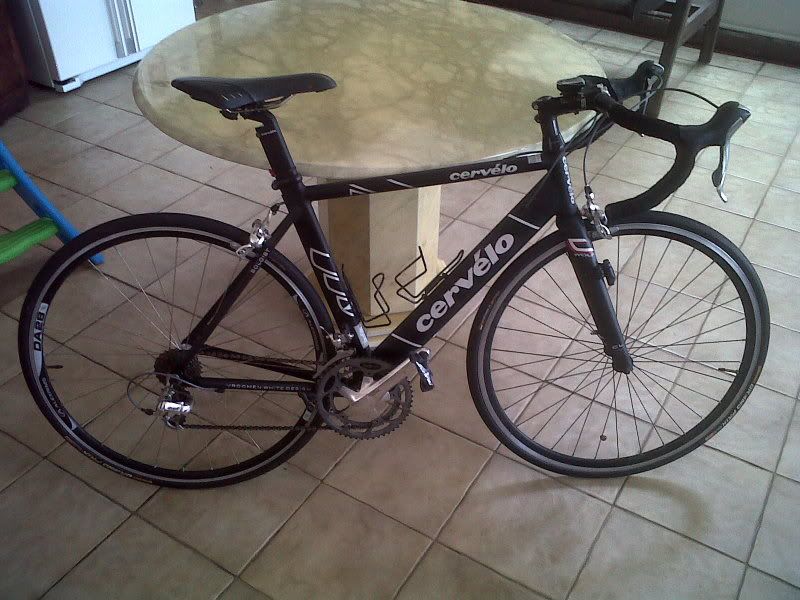

i am currently selling my 2005 cervelo soloist with full integra, so i thought perhaps i could take all the components off that and just sell the frame, leaving me with all the components i need to get the colnago on the orad with modern parts. could i even use the forks, but that would look a little odd i guess? (i'm not plugging my soloist sale, as it's in singapore!)
