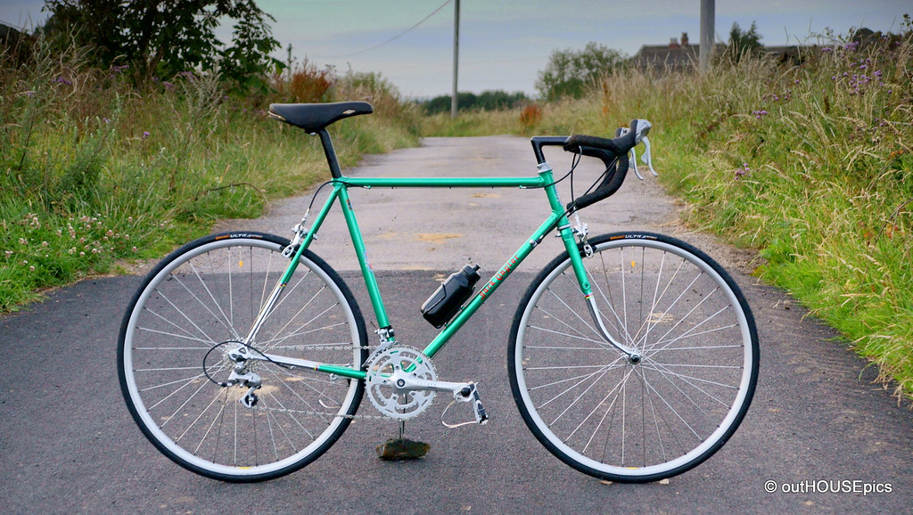

Did it on my '73 Jack Taylor with 90's bits...
Jack Taylor Complete by outHOUSEpics, on Flickr
That's very smart 8)
