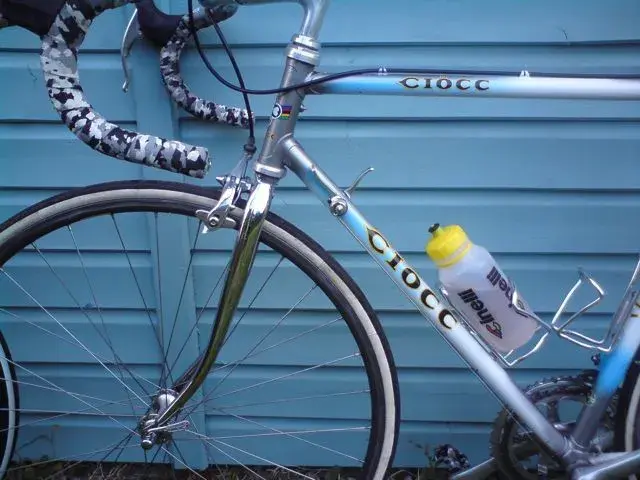

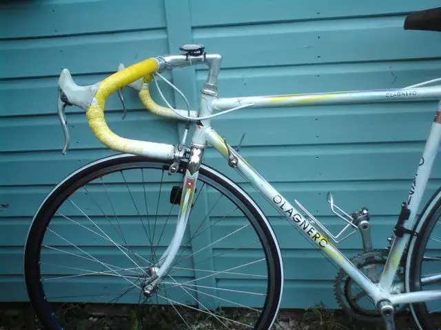

Hi, here are two of my steelies, both Aelle tubing; the Olagnero (52 seat / 53 top ) has original forks whereas the Ciocc ( 53/ 54 ) has replacement forks.
As you can see the Olag sits snug on the fork crown whereas the Ciocc has a gap between the headtube and crown resulting is pushing the wheel further in front of the down tube. The front of the bike sits marginally higher I think, but rides perfectly.
So... is this 'wrong'? how is handling affected? do I need to fit new pair of forks ( Columbus etc ) ?
any comments / advice appreciated

Nice bikes 8) but in my eyes the ciocc wont look 'right' until you fit correct forks, its a lovely looking bike that deserves to look right, proper forks will correct geometry on frame angles and close gap between tyre and down tube, i reckon there's lots of forks on ebay that would do the job, you know you want to :wink:

Have to agree with gordy there.
as I thought :D
so steerer length needed is top of headset to bottom of lower headset less 42 mm for campy headset??? ( I should know this! )
