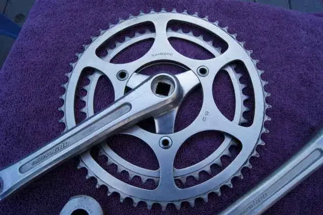

I have a set of unusual Shimano 600 cranks (photo attached). The chainring spider has three short arms. Can't find anything online about these. Can somebody provide some information? The date code is AD, which I interpret as 1976. Thanks!
File comment: Shimano 600 cranks, date code AD

1976 sounds about right. They're in the 1975 catalogue:
http://www.therecyclers.ch/pdf/shim75anglais.pdf
and they feature in a number of print ads from 1976:
http://www.velo-pages.com/main.php?g2_itemId=6568
but they're gone by 1978. Velobase has a little information:
http://www.velobase.com/ViewComponent.a ... 2&Enum=115
The bolt circle diameter is about 95mm, with spare rings available down to 30t. I don't know of any compatible rings: the more common 3-arm cranks used 116mm bcd.
