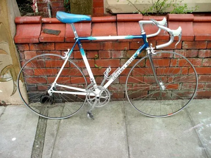

Hope you don't mind "but I wouldn't know exactly what I'm looking for re: rake & colour, so have posted a few pics. Perhaps yourself / someone in here can guide me slightly further ? :-)
Take care buddy, yours Laz

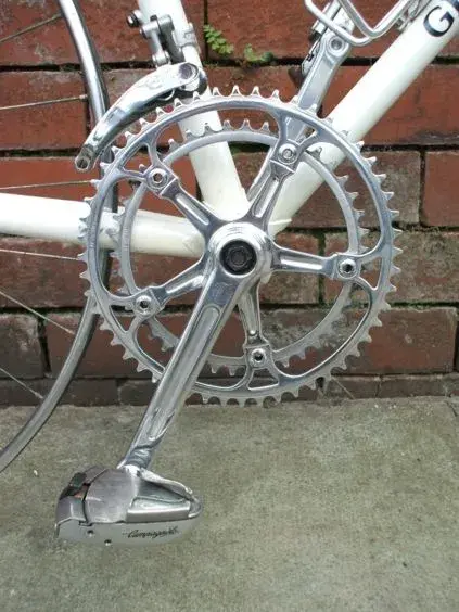

BB area with Tevano crankset
PostPosted: Sun May 22, 2011 10:31 pm
Old School Hero
Joined: Wed Aug 11, 2010 4:54 pm
Posts: 165
Lazarus wrote:
Thanks for that tip Andy, very interesting walkthrough of frame building too :-)
753 forks blades have a very distinctive curve as they were supplied pre bent by the factory.They dont look like 735 to me,check the seat pin size for the frame it will be 26.8mm or 27mm
The tube ends will also be a give away,anything non 753 will probably have factory domed ends
