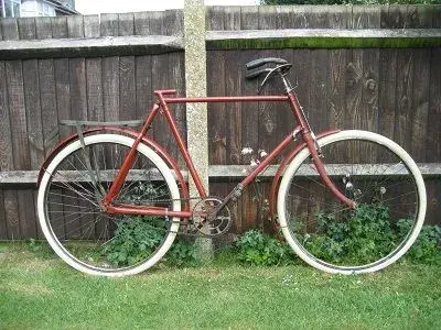

I recently purchased this bike and all I can tell you is that it had spent many years in a garage and the Gent I bought it off of thought that it was a Hercules. Apparently it dates from 1918-1925 ish and was a Police bicycle.
What is not apparent on the pictures I will post is that there is not a "Continental" back-pedal to brake on ths bicycle.
Enough waffling from me here are the pic's.
Thanks in advance for any help you can Youngie

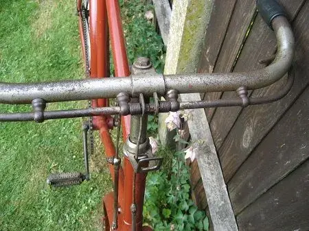

I have 5 more pics hopefully with the info I have provided this will enable an I.D. to be made

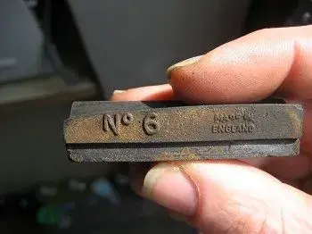

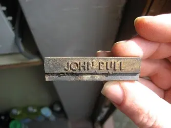

Last 1 of the bike the other 2 pics are both of brake blocks. I don't know if they're original but it might help.

When I saw the first brake block pic I said "John Bull", and so it is, but not original. They made replacements. Nickel plate indicates probably before 1930, but otherwise standard cheap roadster, nearer to 1930. The angles look a bit steeper than I would expect. Single sided rear brake crank indicates not Raleigh or BSA. The lamp bracket doesn't appear to have a logo, or the chainwheel, so could be any one of perhaps a hundred makers.
Does it have any chrome plate?

possibly a royal enfield?

the only bit that has any chrome plating is the wheel rims theese have Dunlop made in England and 28/1and a quarter inch stamped on them. The chrome has started to peel on the front wheel. Hope tihs helps you out a bit.

The wheels would be 28 x 1 1/2, and after 1930, probably later than the rest of the bike. If you had a Sturmey Archer 3 speed it would be possible to date it. So the wheels may be later. Any details on the hubs?

just cleaned off some more crap. Front hubs no markings. Rear hub Phillips Made in England.
Hope this helps
