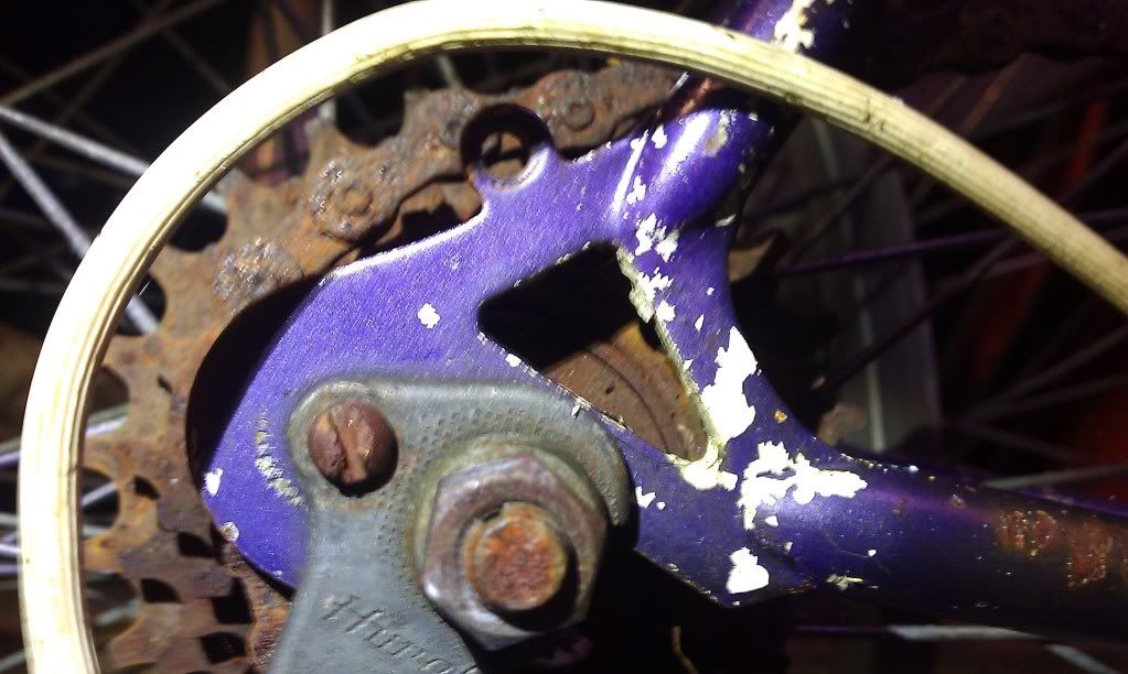

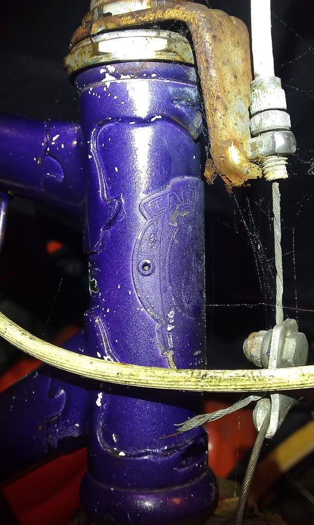

hi all can you help with this model please as i want to bring it back to the original state it was 40 years ago .
I was given this for free when i sold a local chap my 1975 peugeot touring . He has had it from new hence the year , i didn't show much interest in it at first but on closer inspection it looks worst than it is. i dont think the wheels are salvageable but you nether know its amazing what alloy wheel acid can do :wink: the forks are to be stripped and inspected also , as for components its time to get to know the local chromers, brakes , bars , stem are all in reasonable condition. The only reason im going ahead with this is because i fancy a real vintage british cycle and this seams to tick the box , i see there are a couple of resident carlton experts on here so please what do you know chaps?
cheers,
Lee.
the green is base colour

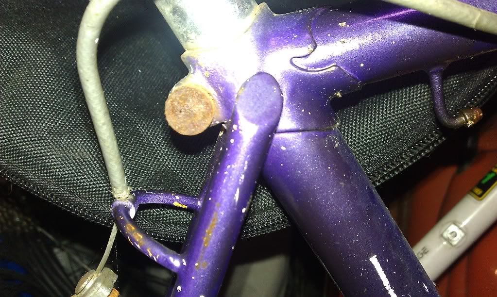

Any chance of a few better images, looks like Crespera lugs but the seat stay treatment looks unlike the usual wrap over type.

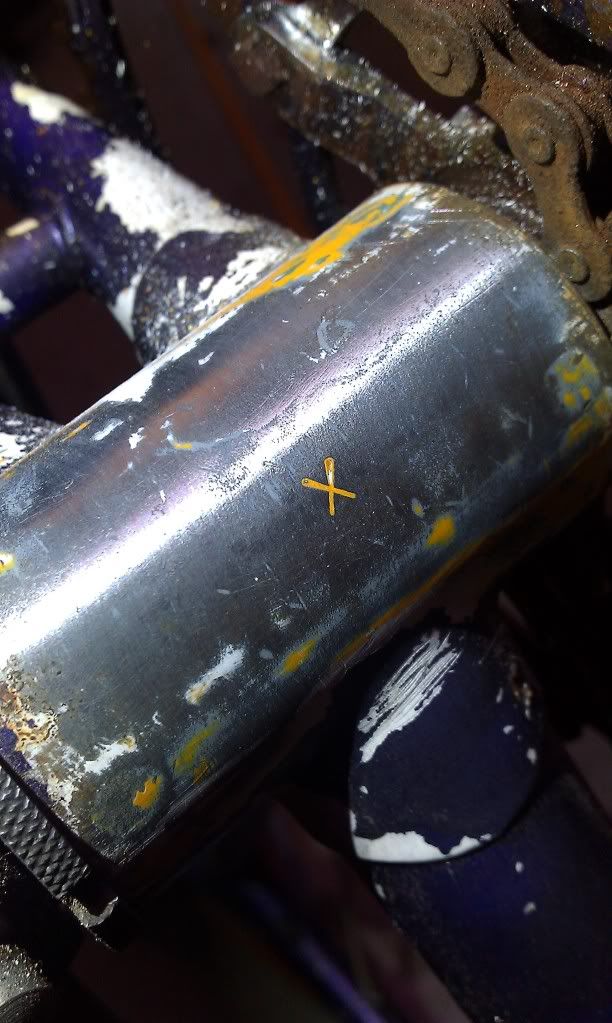

Another point can you see any frame number on it, either on the rear seat stay, BB shell or rear of top of seat tube?
yes i noticed this too, i have cleared all 4 layers of paint from under the bb
starting with the top layer purple, white, green , yellow then metal trying to find the frame no but as you can see X is all thats there , i did check for damage caused when the no's are removed , however there is no damage at all :?

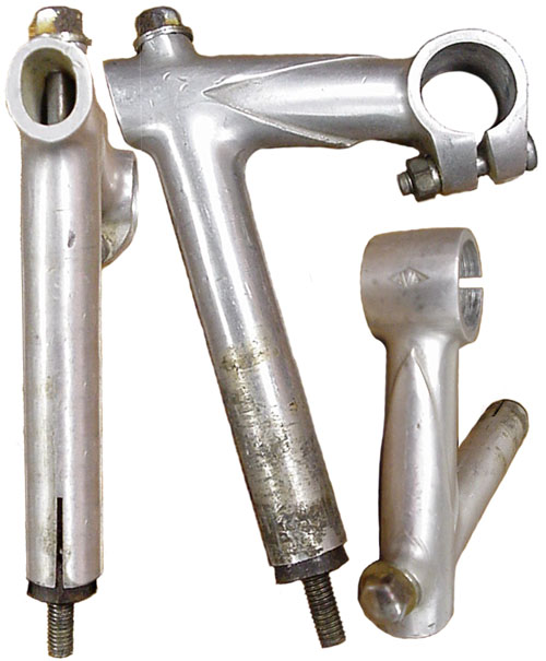

your stem looks like an Ava:
which have a bad rep! Is the stem 22.0 or 22.2mm OD? If the former then it's almost certainly an Ava. If you can get a 22.2mm stem in there, it would be worth swapping?
I've gleaned this from reading:
http://www.sheldonbrown.com/velos.html
... recently, coincidentally!

cheers for that , it does say ava on the stem ,unsure of size as the battery has gone in the verniers :roll:

update managed to find out that this is a 70 corsair ,its in the que for a rebuild, managed to find some nos tange forks as the originals are rotten. I beleive this is the only year the didnt use the rap-around brake stay,

hurray the frame no is 170005
