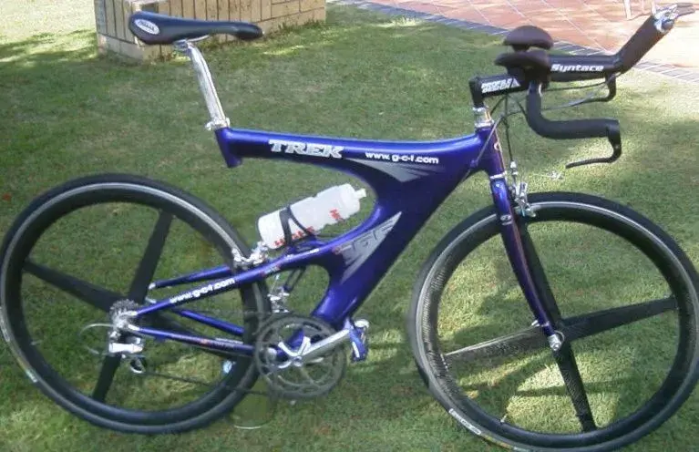

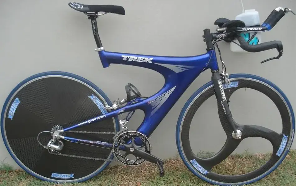

I also replaced the original fork on my Y-foil TT bike (rock shox ready) with a shorter pure road Look one that steepened the head and seat angle a tad and it was fine too
warning semi modern pics below !

the original trek "icon" fork also had steel steerer for threaded headset and quill stems
