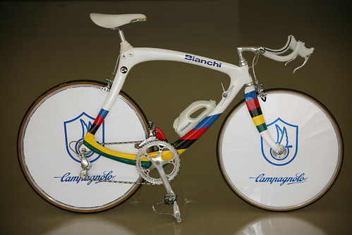

What did folk use for wheel discs in the days before solid carbon disc wheels?
I ask because I've been slobbering over pictures of the Bianchi C4 and it looks to my eye like it has covers stretched over the spokes:
Was this what they used to do? I guess my next question is what were they made of, how were they attached and are they still available?

Looks like they're called aero disc covers or aero wheel covers :)

Those are top of the range Ghibli discs
http://velobase.com/ViewComponent.aspx? ... 1&AbsPos=1
and i guess they are solid composites not just fairings over spokes , in the same "fluid dynamic" era was scirocco (4 holes)
http://velobase.com/ViewComponent.aspx? ... 1&AbsPos=5
and the cheaper Khamsin disc
http://velobase.com/ViewComponent.aspx? ... 1&AbsPos=4
which I have for my Steel Merckx .It is contructed with woven glass over foam core (each side) and the graphics are printed onto a big white sticker which leads me to guess the Khamsin is more expensive kevlar over foam core.

There were options such as plastic or fabric 'skins' over a standard wheel, or full aluminium disc wheels like mavic challenger ones:

In the mid 80's you could buy wheel covers that you glued to a tubular rim to make a disc wheel, dont forget that Francesco Moser broke the hour record with a weighted rear wheel that acted as a flywheel, so that when he got going the wheel kept going at the same speed so helped him keep the same speed . As it was covered up nobdy could see the weights inside, so it was legal.

There was also the J Disc which was a regular wheel with a polyester film glued to the rim and heat shrunk in place - it was tight like a drumskin, unlike the Aerodisc cover which was a sheet of plastic. I still have a pre-carbon disc wheel which is a sheet of phenolic honeycomb with a 2 piece hub screwed to the middle and a tub glue on the outside. Weighs a ton but feels fast when rolling.
