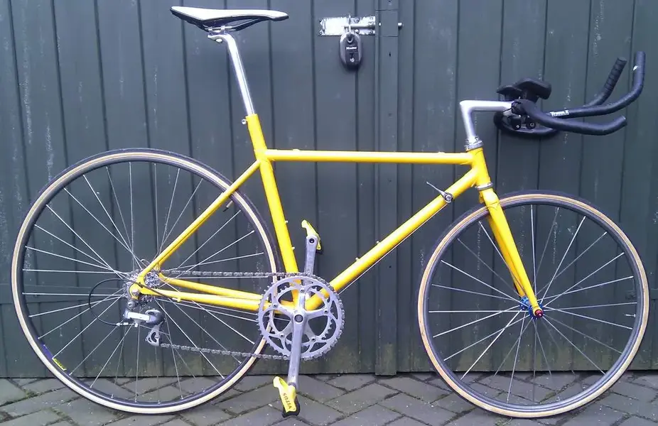

Just bought this outrageous piece of vintage steel and I'm building it up gradually into something that I can use in vintage bike time trials - my times are likely to be vintage too, probably best measured with a sundial. Ok, I know it's all wrong at the moment, I need a single ring chainset as it's meant to be run as a 7 speed, there's no brakes on it (who needs them?) and I'm not entirely happy with the bars, they are a touch too low and not quite long enough.
Details of the frame are that it's intended for a 24 inch front and 700c rear, the front appears to be original with an early Hope hub. There is only one gear lever braze on but oddly it has two sets of bottle cage bosses. The frame is likely to be of 531 or similar with a 27.2mm seat tube, but there are no marks anywhere. The seller reckoned it might be an Aende by Pongo Braithwaite, it'd be nice if it was.
Hope someone out there recognises it!
Gordon
If that's your correct saddle height then the frame's too small.

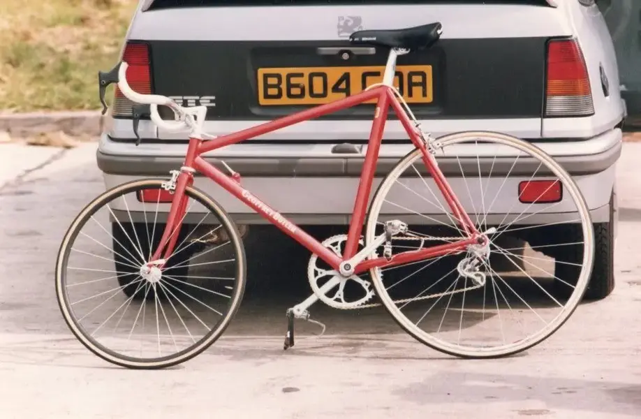

fiks wrote:
The saddle is about an inch too high as the post won't go any further into the seat tube as it hits the butted portion so I need to chop a bit off it. For a frame of this type it's probably about the right size, it's 51cm ctc top tube, which is only 1cm less than a couple of my road bikes. It's the fact that it's such a squat frame that makes it look very odd, take a look at the top tube, it's level with the top of the rear wheel. If you look at other low pros they often have a sloping top tube, if they had the same geometry as this one they'd have a similar seat post length. See the Geoff Butler below for example. If it is too small, tough on me, I've built it just for fun really!
Gordon
