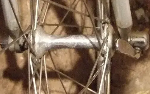

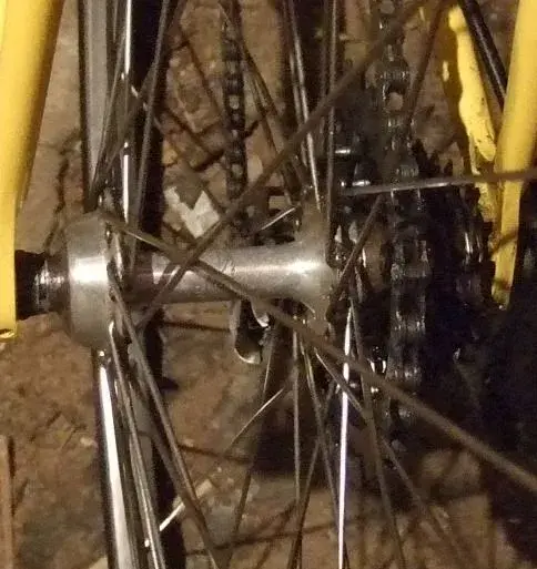

Heres a couple of pics, I can't decide what they are. Ideas ?
1251 small flange maybe ?

Those hubs look like Campagnolo Tipo they use 1/4 bearings on the rears and smaller 7/32 on the front.

Yes, Nuovo Tipo/Nuovo GS. The front one use the more regular 3/16 balls however, unlike the NR/SRs. The cones are of lower quality. The rear cones can be switched out with NR ones, but the fronts of course not.
