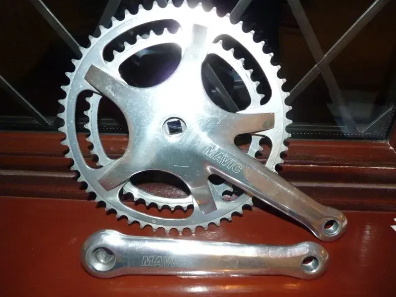

just bought/won a mavic starfish chainset on evilbay, never had one before, always wanted one as i think they are one of the most beautiful chainsets ever made. :D
http://cgi.ebay.co.uk/ws/eBayISAPI.dll? ... 500wt_1054
haven't decided what to do with it yet, whether it will replace something on a current build or be the first part of a new bike :oops: :lol: but either way info would be good.
what's the correct year(s) for this model, i thought early 90's?
the main thing i will need to know is what b/b axle length works with these chainsets and does it have to be mavic? i know campag and shimano didn't mix to well because the tapers are slightly different but i have no clue about mavic either way.

the code on the back is 930624 so how does this code break down?
here's a pic of the chainset, think these are loverly!! :D

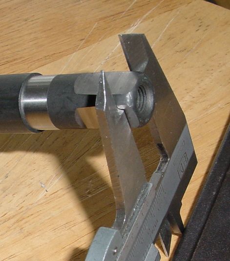

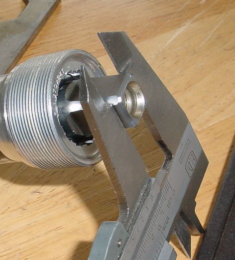

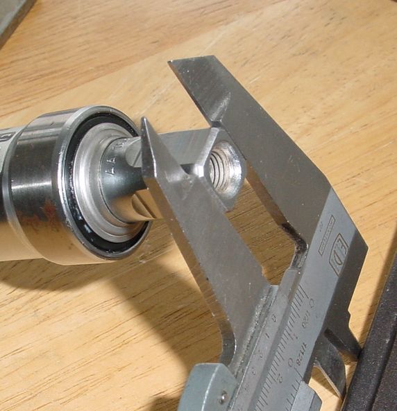

dbmtb wrote:
Where did you find the info?
I made some measurements of a MAVIC axle, a Campag axle, and a Shimano JIS axle, and compared the depth of taper engagement on a NOS set of 631 cranks.
I'm away from home, and I don't have the figures with me. Perhaps to be more precise I should have said "ISO - or as near as makes no difference."
If you read the thread here (I'm the OP):
http://groups.google.com/group/rec.bicy ... 386dbcf68/
you'll find links to images of a JIS axle, a Campag axle, and a MAVIC axle with a caliper set on the first for comparison:
JIS
http://www.businesscycles.com/graphics/taper.jpg
Campag
http://www.businesscycles.com/graphics/taper2.jpg
MAVIC
http://www.businesscycles.com/graphics/taper3.jpg
Many people seem to find they work well enough on a JIS taper though.
