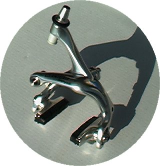

what do you mean by 'dual pivot'?

your brifters will be fine
dual pivot:
Image?1227122309
single pivot
