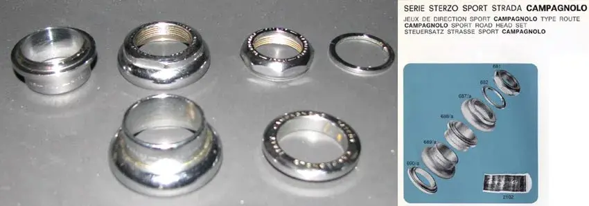

The headset I have is the one in the photo below, so it is the Sport then, 1040/A? Got the engraving and only two spanner flats on the upper cup you mention.
I'll look at the Mafac brakes when I get home. I got them on here a while back and I'm pretty sure they're not the M.A.F.A.C. ones you mention, they've got those red bushings too. I reckon they'll have to do though. They came with levers with full rubber hoods too. I've wondered what period they're from. The levers are half closed / half open at the back and have brass adusters. Am I right to think that indicates later, 1970s probably.
Anyway, many thanks for showing interest and great pointers on the early Campag headset models.

Yes 1970's 1040/A!
