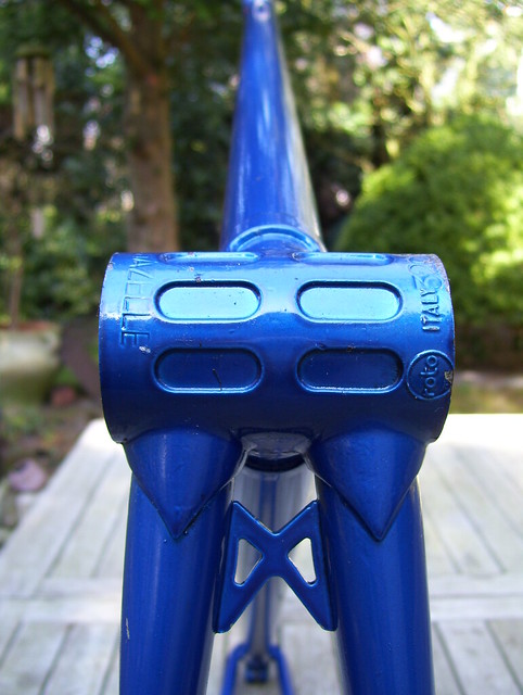

Roto shell and 'X' reinforcement shown on late 70s AA
Image Image
