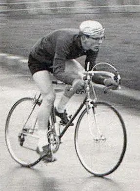

This is is the way all the 'old-timers' in the 50's and 60's used to run with Campagnolo bar ends which didn't have the mechanical smoothness and 'modern' cables prevalent now.
It's how I used to route them BITD - not a good photo but you can probably just see the cables coming out from the tape at the top.

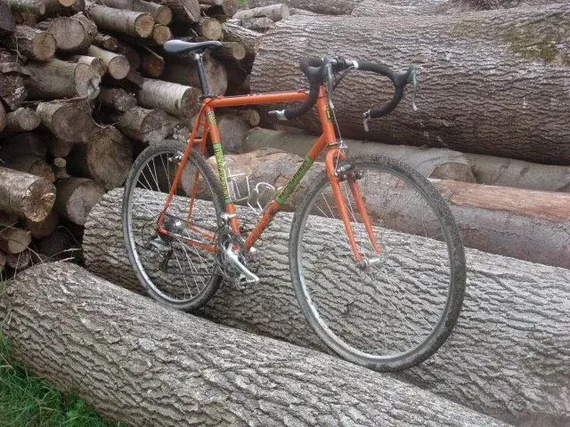

I've some bar end shifters where I've run full outer to emerge with the brake cables at the top of the tape - not a great or specific photos but you may be able to see here. I've not had any particular problems.

Thanks for the pictures Ed & Ned - that settles it then, I thought having them exit low down could get in the way, now I'm happy to go with my first idea on this.

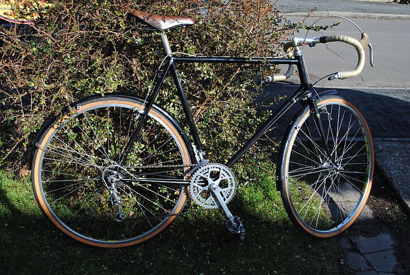

I have the cables bare as I change things a lot:
