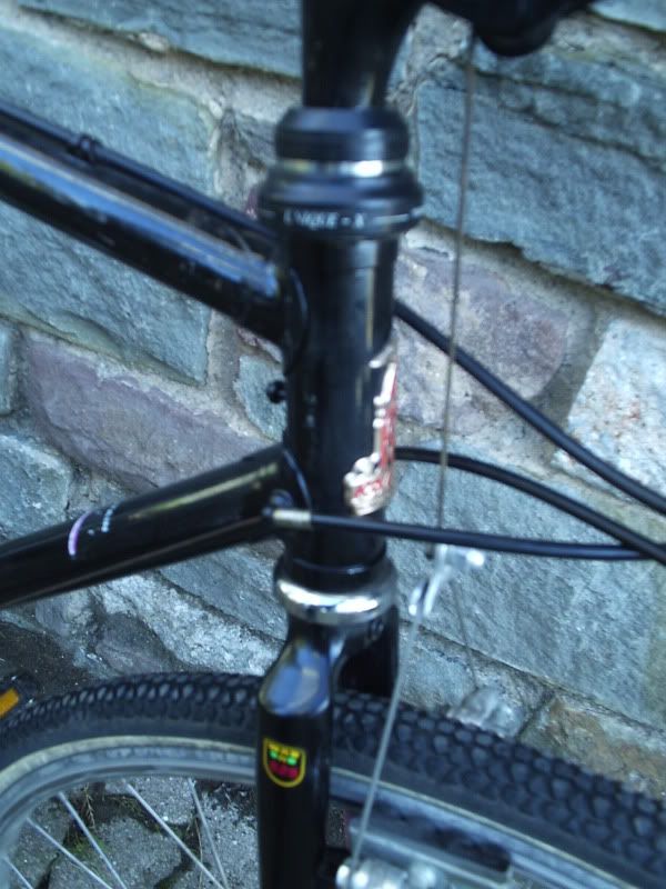

Looks like a 'cross bike with flat bars (not the original seat or post, they were missing):
& here's the cable stops, sadly not threaded for adjusters but should be able to work something out:
Just need to decide on the right drops now.
