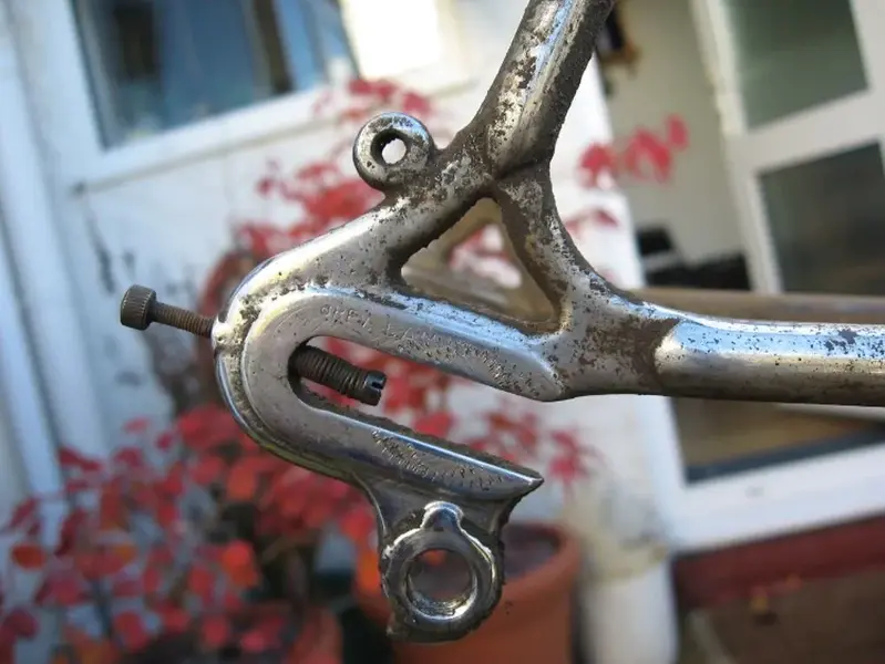

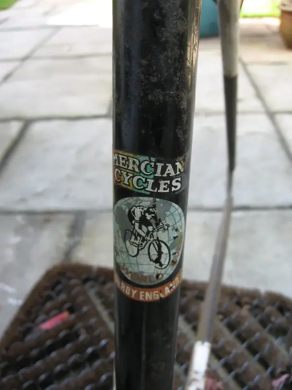

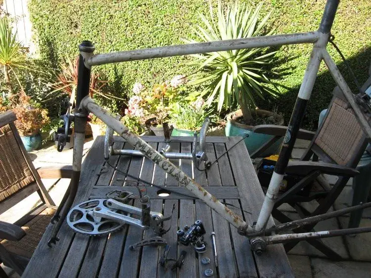

Here are some photos of the bike and I would welcome any help identifying it.
I'm going to sell the gears, bar/stem & chainset separately to make some money towards the powder-coating of my Marin mountain bike.
I don't know whether the frame is saveable or worth saving but it is a light well made frame with Campag dropouts. The seatpost looks well stuck and I didn't want to cause further damage by trying too hard.
It seems a shame to bin it so if anybody is interested in a winter project/challenge I will give it to them for the cost of postage, or collection from Cardiff

I wonder if this is a Mercian-resprayed Raleigh Professional:
http://i-vol.com/bikes/raleigh_professional/
The Gxxxx number would fit an early seventies Raleigh...

I reckon you've nailed it :) . The lugwork, chrome, dropouts and crown are identical (but I wish it was in as good condition :cry: ).
I thought it must be 531 tubing from the sound of it.
My offer still stands about giving it to anyone who thinks they can make something out of it. Would make a great ss/fixed-wheel.

I would have expected Mercian to make a far better job of the rear fork end.

As a non expert, what's wrong with the rear dropouts :?: I thought it was just rust and damage through use/neglect.

A true hand builder would braze the seat and chain stays on centrally on the spigots. The fork ends would then be profiled by hand.
What we see here is the seat stay brazed too far forward and no attempt to tidy it up. Also the chain stay is too low.
Still can be described as "hand built" to add to the confusion.
Presumably Carlton under pressure.

One other thing that made me hesitate to identify it as a Raleigh Professional is the rather abrupt straight-bend-straight profile of the forks. Most Worksop/Ilkeston bikes of the period have a more elegant, gradual bend, either maintaining a constant radius, or tightening towards the tip. Perhaps this was a Friday afternoon bike.
It would still make a fine project for someone, and it's a very generous offer on gerryattrick's part. I only wish I had the time and space to take it on.
