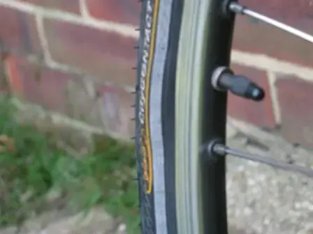

I agree with monty dog's view wrt weight v durability; however, my personal preference for touring and commuting is Continental City Contact. A key advantage is that they should be available as a tyre and tube combination guaranteed for a year without a puncture. If you get a puncture and have proof of purchase the supplier should replace the damaged tyre and tube.
I have been through 2 sets and Wiggle honoured the 1 year guarantee when one of the tyres from my second set developed a slight distortion (bulge) on the sidewall resulting in the inner tube being pinched and getting a pinprick slow puncture.
That was the only puncture I had in 4 years of commuting 60-70 miles a week and often picking up needlw like shards of flint that can be plucked from the tyre with tweezers.
Since the replacement about a year ago my averaging commuting distance has come down but I have done a number of long rides with no further punctures.
ff
