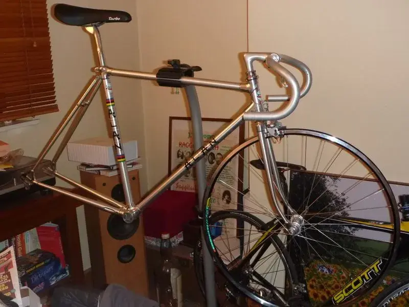

When are you going to give us a photograph or two?

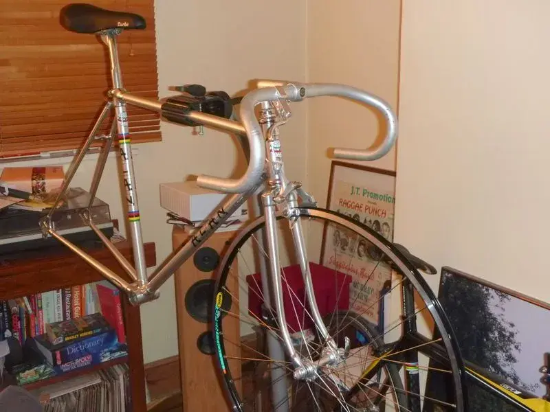

PostPosted: Sat Sep 04, 2010 9:48 pm
Joined: Sun Mar 30, 2008 2:01 pm
Posts: 349
Location: South West
Pic as requested.
The frame has no braze ons so it's just got to be fixed.
