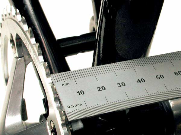

Whats the best way to measure the chain line?
PostPosted: Tue Aug 10, 2010 12:52 pm
Joined: Wed Feb 20, 2008 12:21 pm
Posts: 5806
Location: Lost in Translation
Like this:
http://www.sheldonbrown.com/chainline.html
