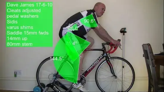

been riding road since Christmas and LOVE it !! 8)
Brought a new bike last week and spent the best £100 yesterday having a proper set-up with a guy called "bike dynamics" mainly due to forever playing with my previous bike trying to make it comfortable with knee problems and just getting fed-up with it
The outcome for me was brilliant!! and it really opened my eyes to how even the slightest change can improve things and now i know its set up perfect for me with all the measurements to transfer onto any bike i ride.
No more fanning about but also no excuses !! :D

Yes, money well spent. It took me two years of faffing around to get things right on my road bike. It's well worth it as I can now spend 100+ miles in the saddle in comfort.
In general, road bikes have too tall gears and too low bars. IF you never use the drops then they are too low. They should be functional and not just there for decoration :lol:

started road biking last year with no experience at all. built the bike on my own with help from the online resources. took me a while to find the proper setup but after two longer rides in the last weeks i think i found my final setup.
i totally agree that minimal changes can have a huge effect. spent about 1 hour in the drops on a recent ride which made my balls hurt quite a bit. altering the saddles nose down a bit solved the problem.

it was quite funny with my upper riding position, the man said my position was very aggressive and was surprised i did not have any back shoulder issues. So when fiddling about he tried a shorter stem to create a more sporting position but I still managed to naturally create my aggressive position with the shorter stem so he gave up :lol:
I'm off to mayhem in a min but if anyone is interested in the PDF report i have been given for the appointment PM me and i will email it over. It does make interesting reading.
