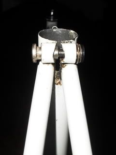

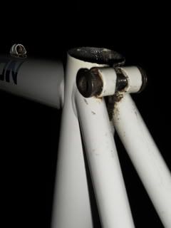

I'm in the process of building myself a new bike and didn't pay enough attention when I bought my new frame (Peugeot Triathlon). I'm cannibalising my dad's old Raleigh, which has decent Weinmann centre pull calipers that I'm hoping to keep. My new tiny (short, bike-illiterate girl-sized) pug frame doesn't have the same cable bridge and mount set up as the Raleigh so it stumped me a bit. Apologies for likely use of wrong terminology.
I've looked at rear cable hangers but due to the size and configuration of the frame i'm not sure what to do...help please?

I think this is likely to be too long - http://reviews.wiggle.co.uk/7867-en_gb/ ... eviews.htm
And due to the integrated seat clamp i'm not sure that this will fit either -
http://www.jensonusa.com/store/product/ ... LUK&cc=GBP

The one from Jenson USA should work fine with the allen key fitting and I do hope you have the seatpost for that Pug as they are rather hard to source!

Thank you!
Yes, seat post came with the frame fortunately. It's well on its way now, some more parts on (more for safe storage).

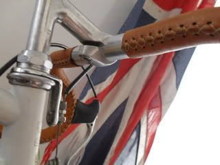

Perdy - where is your brown bar tape from?
I've been after some :)

It's a leather wrap -
I got mine from Fresh Tripe but Velo Orange sell them too. :)

While I concur that the Jensen cable hanger will fit I have to say that the Weinmann centre pulls are pretty poor performers. They were all the rage in the 70s up to mid 80s, esp. with Raleigh, I used them myself but really gave no better, probably worse, braking than the Weinmann side pulls. The main reason I used them was that the side pulls were notorious for going off centre and hence one block would rub the rim. Modern side pulls are much much better, so unless you really have to have the Weinmann CPs off your dad's Raleigh don't waste any further $ on them. It also looks from your photo like your front one is marginal for block adjustment, just slightly too deep for the rim. If you really must have CPs, and appropriate for the Pug frame, get some Mafac Racers on ebay.
