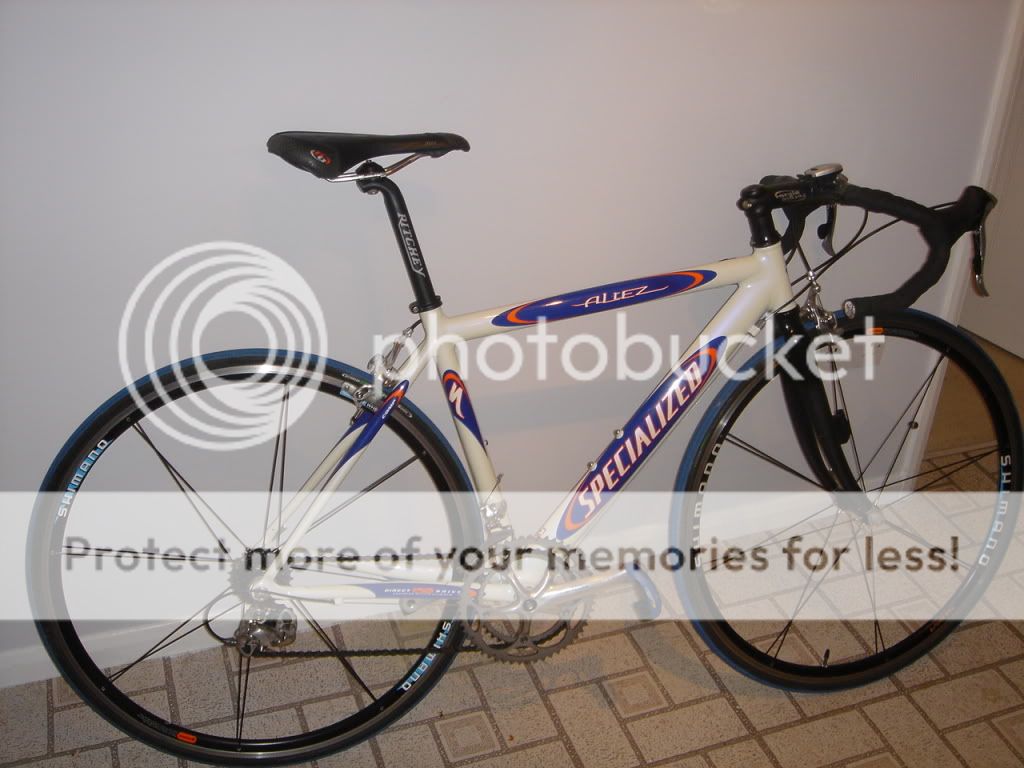

This is an awfully stupid question but here goes. I need some info on the best size road bike for me? I am 5'10" with a 31" inside leg (I think :? ). How do you go about sizing them up?? :oops: :oops: :oops:
Any help would be much appreciated as I used to have a Specialized Allez (I suspect collective groans :lol: ) and I loved it but sold so I could go travelling. I want it back!
Any ideas' on cost to replace my old Allez?:
:D
