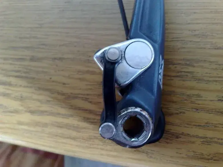

Hi, I've just recieved a lx brake from STW, was wondering if the parallel push arm is meant to have a kink in it, my XTR ones are straight, others I've seen are straight, putting it on the frame, it doesnt seem to line up..... :?

i havent seen one of those brakes in the flesh so cannot comment if it should be kinked or not, but i would imagine it would be hard to kink it without it looking damaged. also the pivot points do look parallel so it should line up perfectly. see the foto, and check that the lines are parallel as the pass through the pivot points. also, the locating pin should be in the central hole in the frame or forks if you have a choice, dont be tempted to use an alternative to get 'more' tension.

Your right, once lines are on it looks a lot better, awesome bit of technical help! Ive put it in the central locating hole on the frame boss. I'll have another little tinker with it,

Just had a quick look at mine and they look the same with a slight kink so I wouldn't worry.

BTW that kink looks very much like something only manufacturing could achieve as everyone else has stated.
