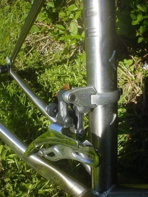

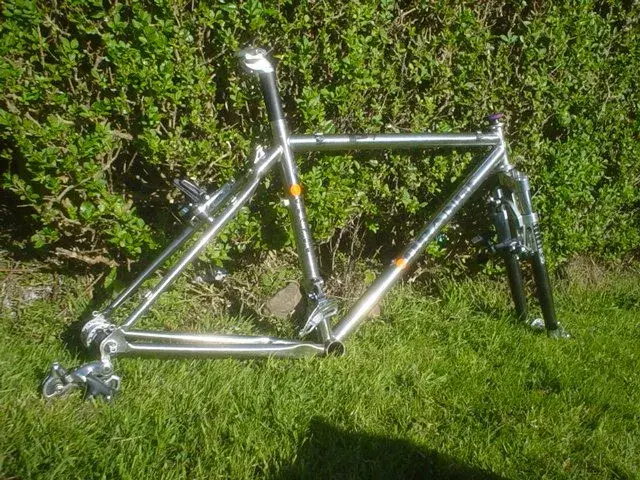

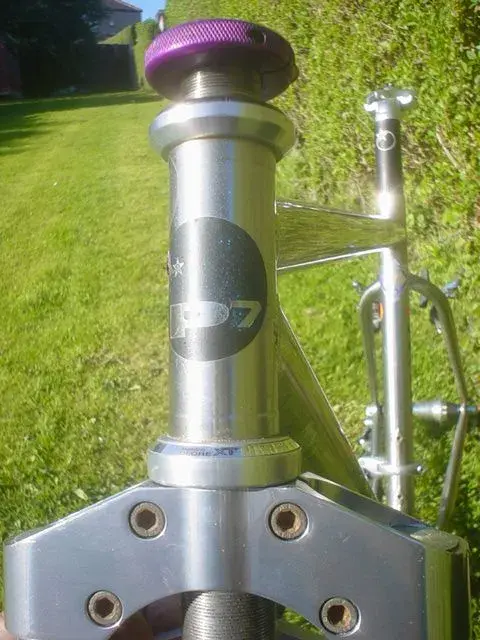

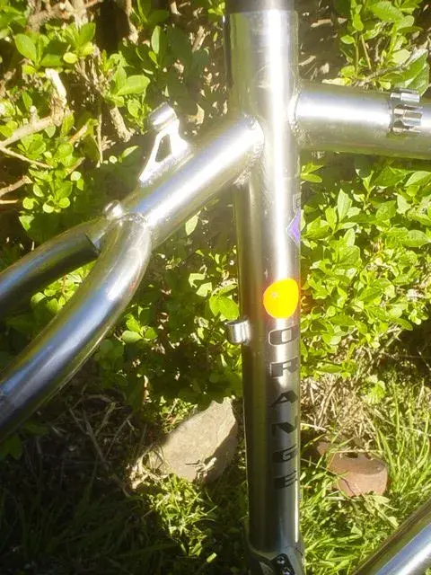

After some X-lite bars, got some Chicken stix levers. So it's going to be a fairly British bike. I am a little reluctant so show pics as i havn't given it the final clean yet, but as requested.. So far ..........

What's going on with that Pace steerer? Looks threaded at the top and (where it shouldn't be sticking out) at the bottom! :shock:

yes indeed, they were 1" 1/8th steerer fork. i have a 1" titanium steerer inserted in to the 1''1/8th whilst i am waitin for my converter shim to arive from Pace.
