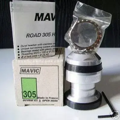

Loving the bike....for me the Mavic headset is a piece of art, love mine to bits...would only consider changing it for something like a campag one...
In reference to the bearing I think you've sorted it but here's a picture on the bearings in their nylon race...
