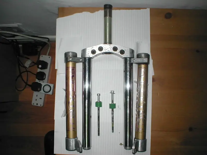

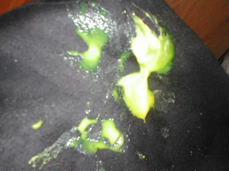

today i picked up these shocktech forks from BADGER on here as a gift.many thanks brother!! i just had to dismantle them, with a permanent grin throughout, i like these! i have now reached a point where re-assembly is impending. i need some sort of info regarding what should be observed and fitted to get them up and running. once the legs were seperated from stantions dark grey oil ran out of the stantions from the top. when the legs were totally shifted the threaded bolt had a horrible yellow guey stuff on the thread itself, went everywhere! then, once the bolt had been removed from out of the stantion it has a blue rubber bung at the head.
a fairly simple layout but, oil is involved here so im out of my depth.got any ideas, info, manuals? first pic is grotty but applicable :shock:

I serviced a few pairs of the carbon versions when I rode for a team sponsored by Shocktech back in the day. If these are the same as the carbons then there shouldn't be any oil involved, the grey stuff than ran out when you dismantled is probably a collection of water, grease and general crap that's accumulated over the years. The horrible yellow stuff is what's left of the elastomers - I have a set of the carbons in a similar state.
Assembly should be simply a matter of cleaning them all up and fitting the correct elastomer stacks onto the bolts. From what I recall there is on small elastomer at the bolt head inside the stanchions then a stack of elastomers along the protruding bolt below the stanchion, with each one in the stack separated by a washer. From memory there should then be a split plastic seal that sis on the shoulder at the bottom of the stachion and then a rubber seal that sits it the recess at the top inside of the lower legs.
I think the problem you will encounter is getting the right elastomers as I'm in the same boat with mine. What's needed is the manual or someone with a set with intact elastomers we could measure from as I suspect they'll be very similar to a Manitou stack.
Hope that all makes sense, unfortunately I have an ageing memory but no manual :(

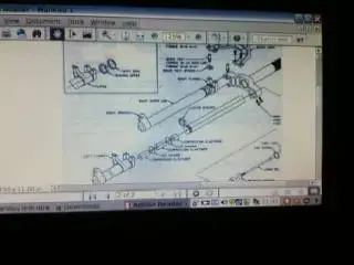

some new guidance on these shocktech bouncers
they are in essence manitou copies so-----
search up manitou one downoad- pick the sixth or so down and you can read up on manitou one in pieces :)
it shows the bits we need and in the right order-something to work on i guess as the parts may be the same stock :?
sorry i cant paste site address-crap pc :oops:

If they are an exact copy of Manitous then the manuals for all models and also replacement elastomer kits are available from here:
http://www.suspensionforkparts.net/esho ... at&catId=8

I bought some Shocktech forks a while back, supposedly with "Like New" elastomers fitted, just stripped them apart today and found one intact elastomer, one white crumbled elastomer, and yellow sticky goo in the one leg I've taken apart so far. :roll:
What will break down the yellow goo? I think the washer(s) that seperate the elastomers are stuck in the goo at the bottom of the fork leg, and it's a bugger trying to get them out :?

The goo....From memory i scraped manually what i could with the head of a long bolt, holding the threaded end. Then, used a wirey brush and hot water for the rest, sort of thing you would clean your car wheels with. That's as far as i got.
