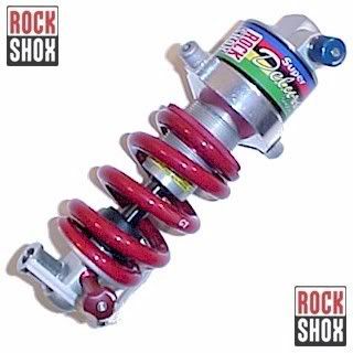

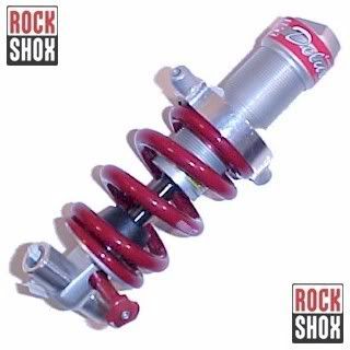

ICYCLESUSA http://www.icyclesusa.com/ Trunion shocks Coupe and Super Deluxe and Lobo Pull Shocks

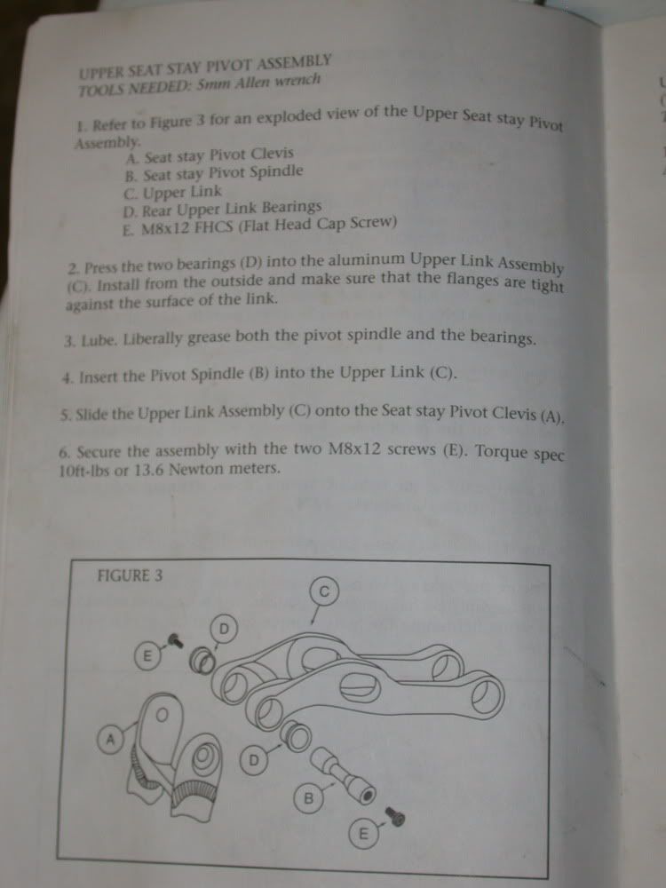

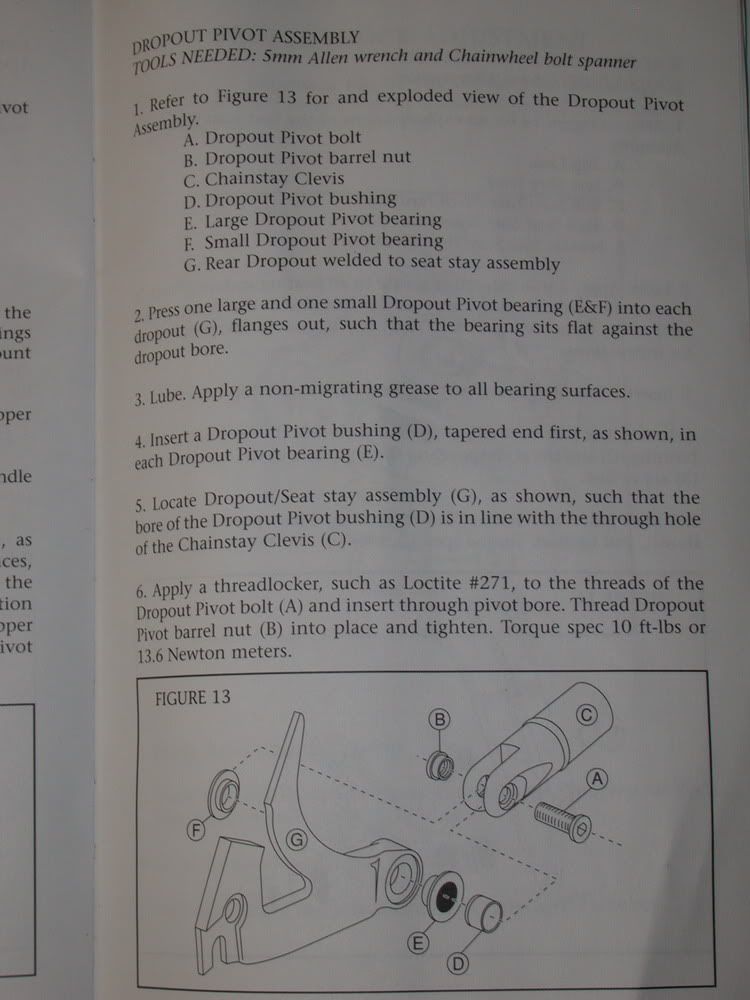

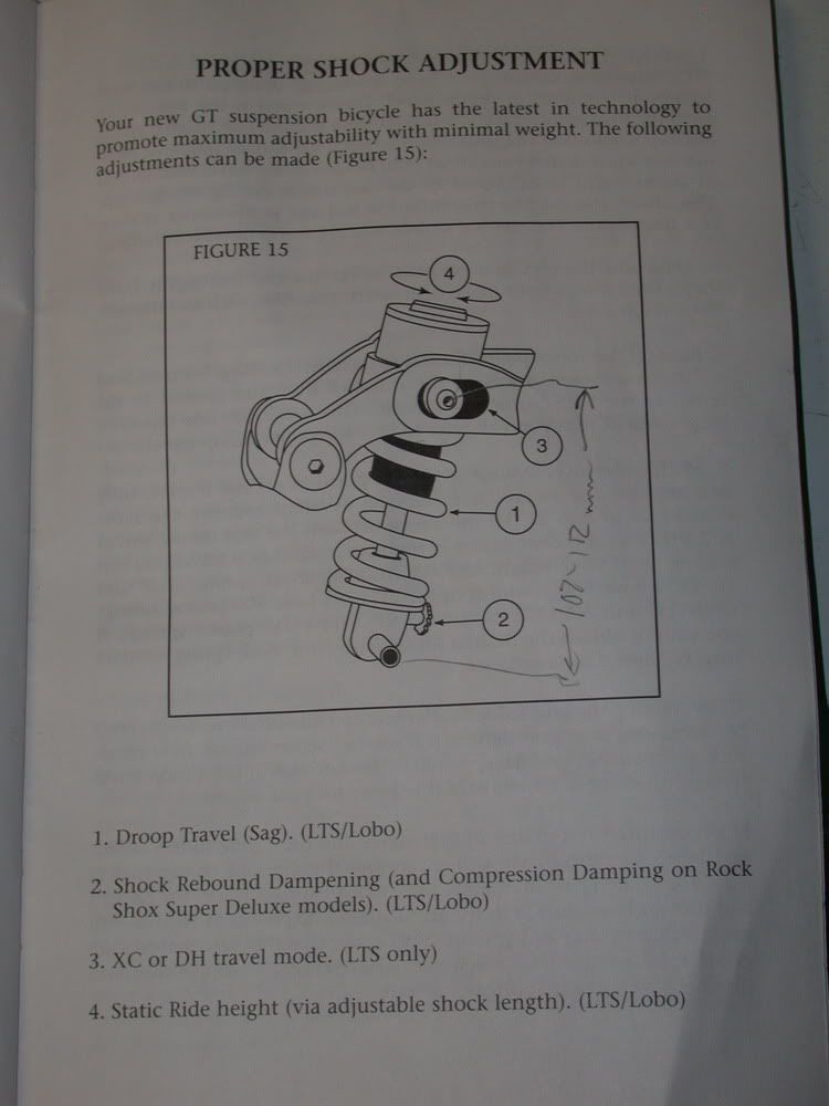

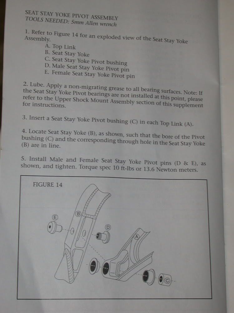

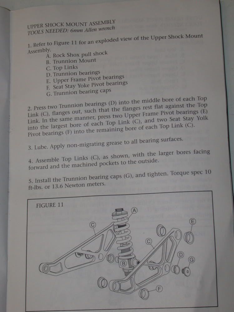

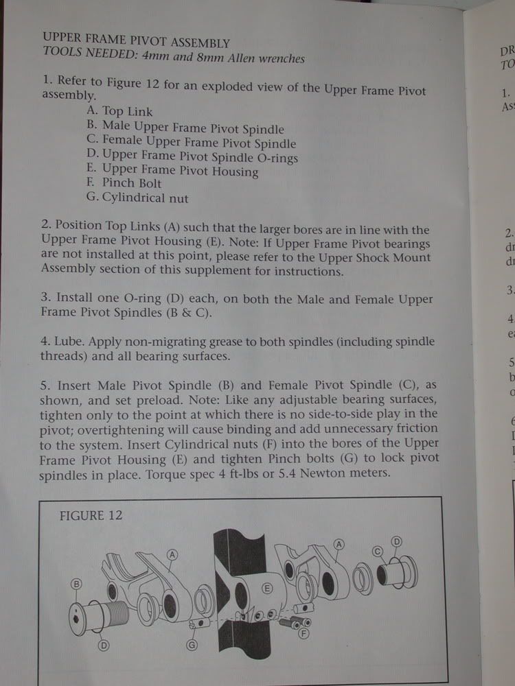

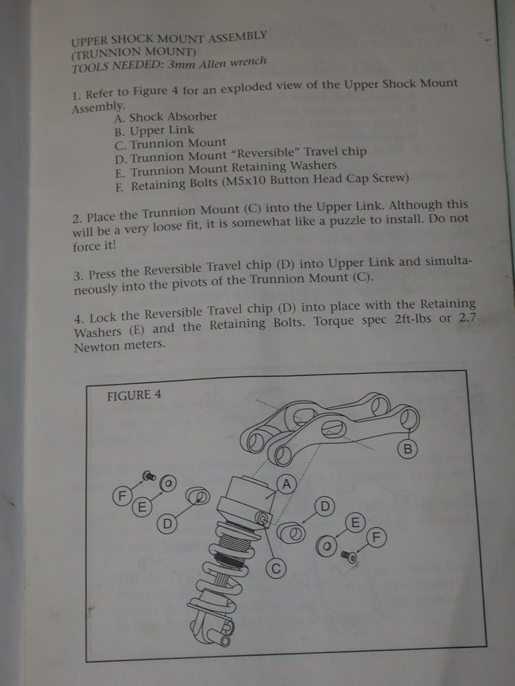

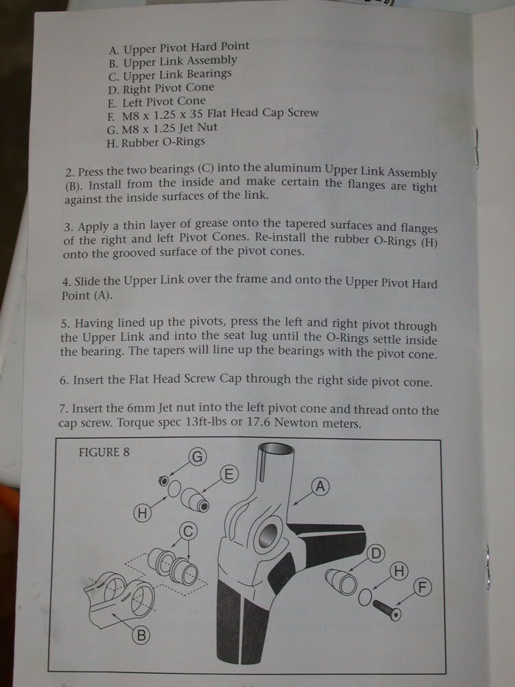

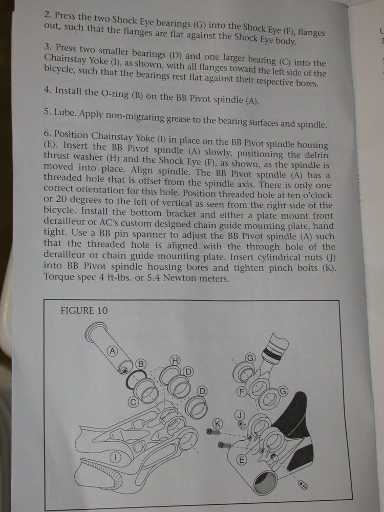

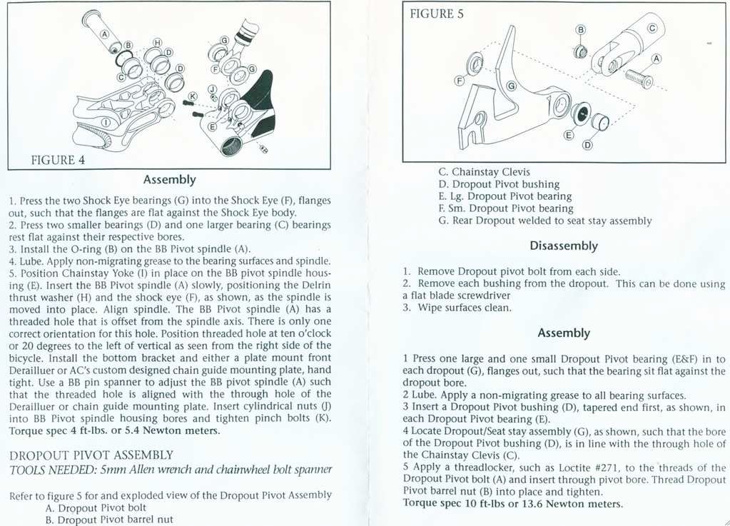

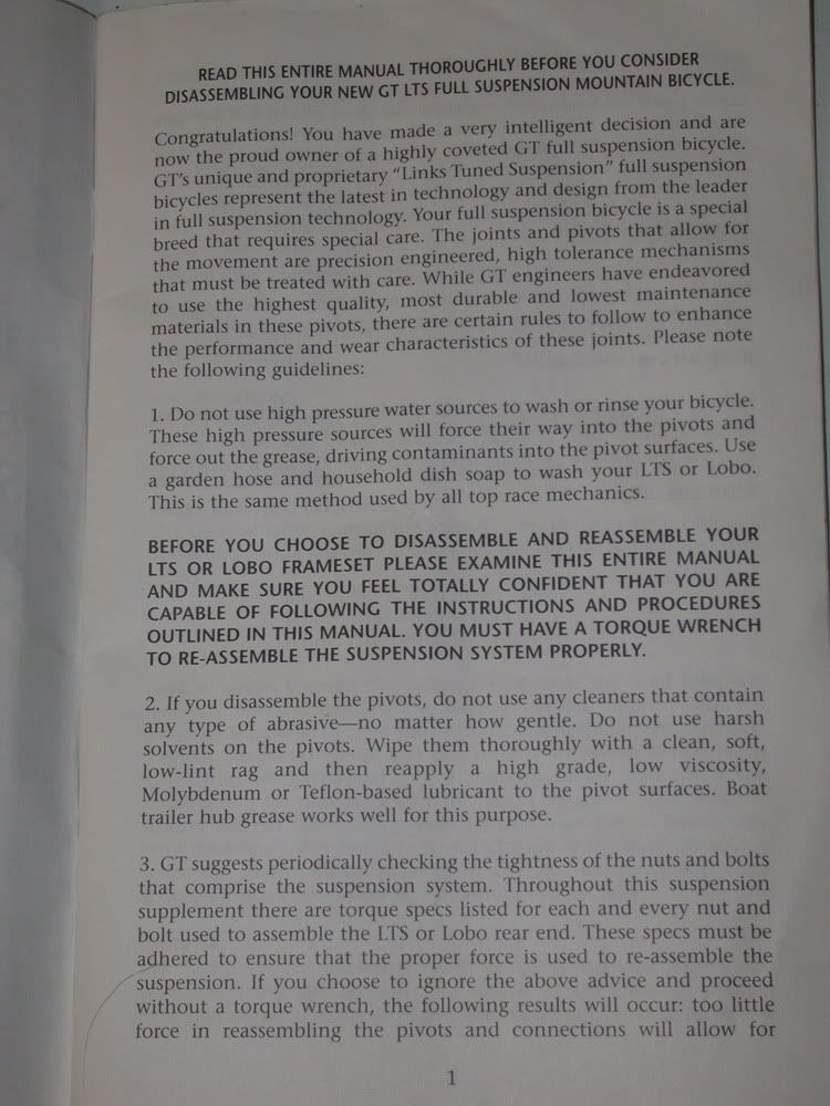

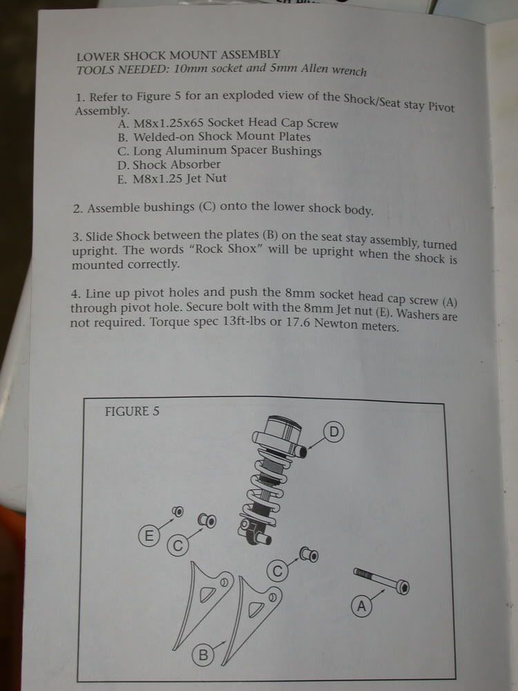

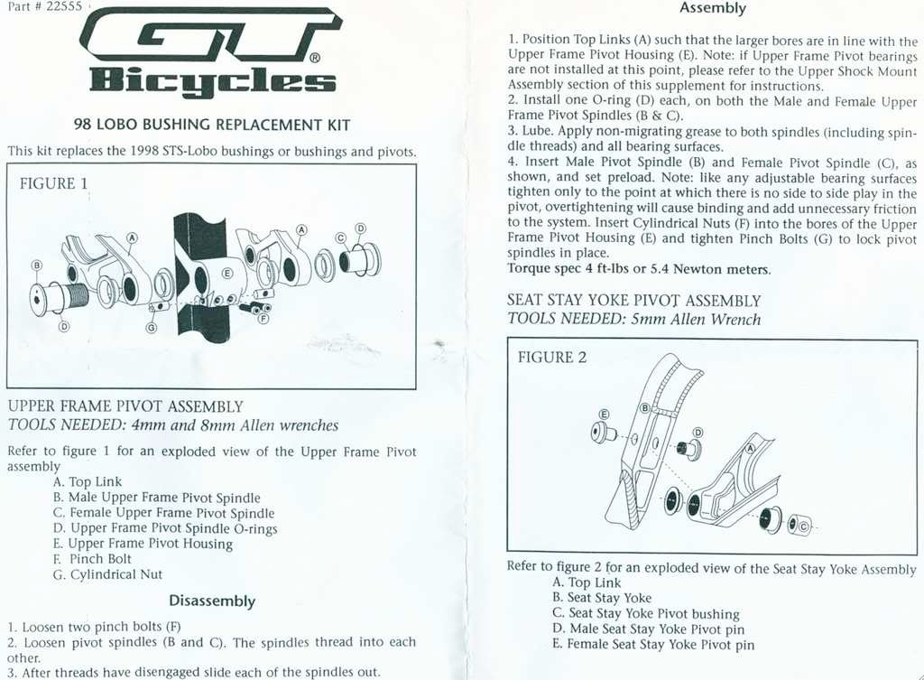

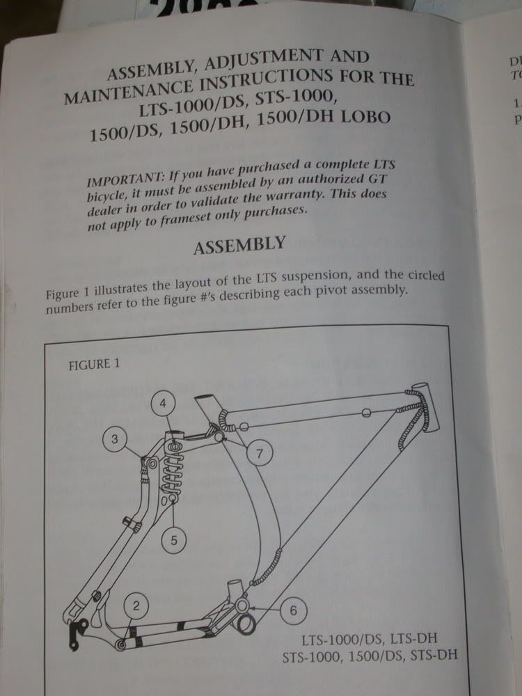

TECH and Magazines
1998 GT Lobo Rear
1998 Full Suspension Sipplement

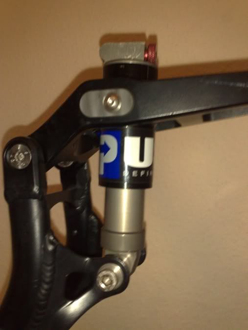

Here's my three to start the ball rolling
Firstly a '98 STS-DS 1000 that has a Black Anodised rear end and an interesting Fox Float. This appears to have been modified by PUSH Industries and given a threaded outer casing to fit the trunion mount. I have sent PUSH an email just to confirm whether it was actually them that carried out this modification. Still waiting on the reply though :( Hopefully they still carry out such mods and can give me a current price.

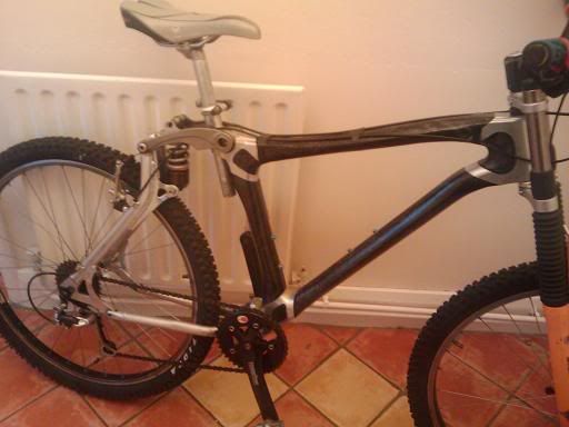

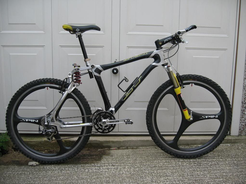

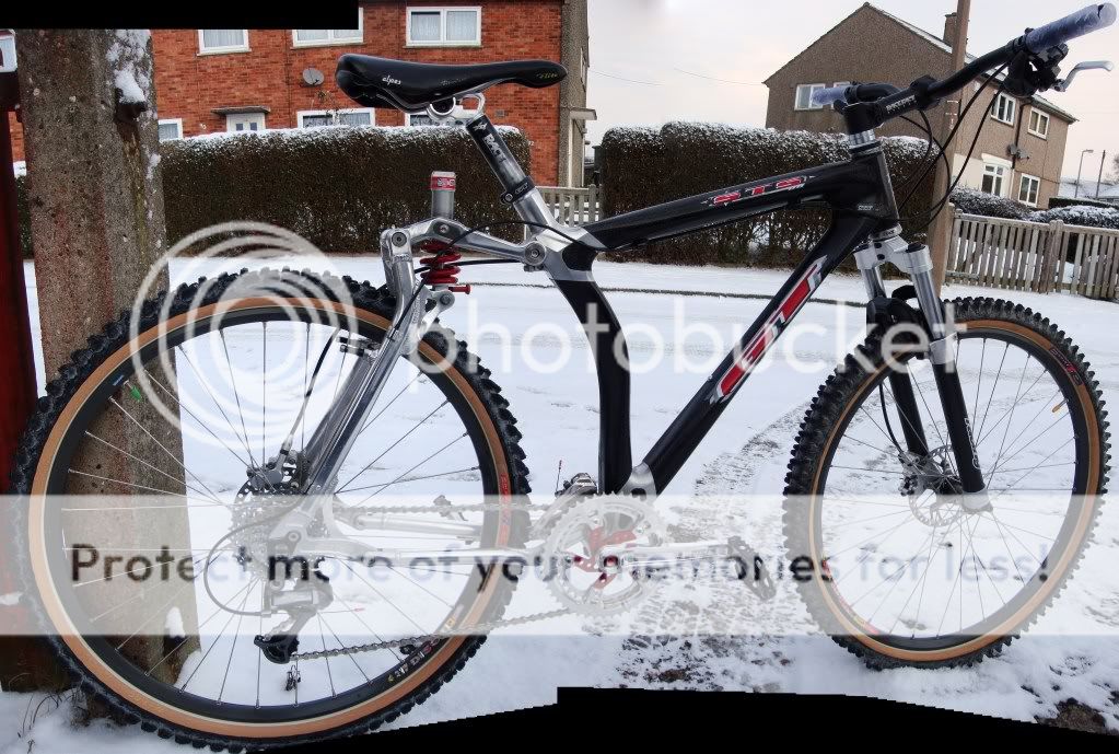

I'll start to add to this Gadro as I rebuilt mine from top to tail with new bearings and bushes. It doesnt have that kinked rear at the mo... I was faffing with locking it out as much as poss when I was taking pics. Just needs a granny ring at the mo!

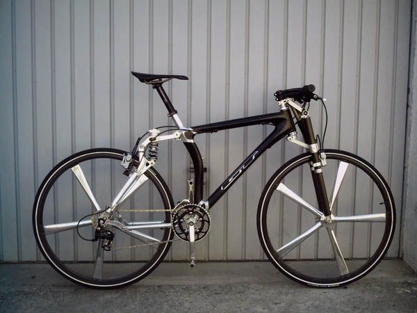

Here´s my last STS-1 build, first one cracked at the seat tube ...
Sadly sold to buy the Titus ...
More pics here:
http://s27.photobucket.com/albums/c188/maxhc/?start=80
http://s27.photobucket.com/albums/c188/maxhc/?start=100

There you go 2 stunners 8)
Seeing all this Carbon and Aluminium makes me realise just how 'bling' these bikes look
Steve that build looks very clean. Love the look of that Kooka Crankset. How did you go about making the hydraulic hose line fit on the top tube cable guides? Zip ties? I resorted to drilling out the ones on my Lobo so I could fit snazzy Hope hose guides. Nerves of steel required though :) Resorted to simple 3M stick on ones on my DS. Not perfect but neat and tidy. Looking at your bike also makes me think how much I want amber wall tyres.
maxhc SOLD IT :( :( The internal cable routing of the earlier STS 1,2, and DH gave IMHO a far cleaner look. Nightmare if you lose that inner sleeve though as I found out on my old '97 DH. I also prefer the looks of the aluminium headtube compared to the all Carbon, it gives it a more balanced look although I know that this was a major frame failure point with lots of headtubes getting ripped off by longer travel forks

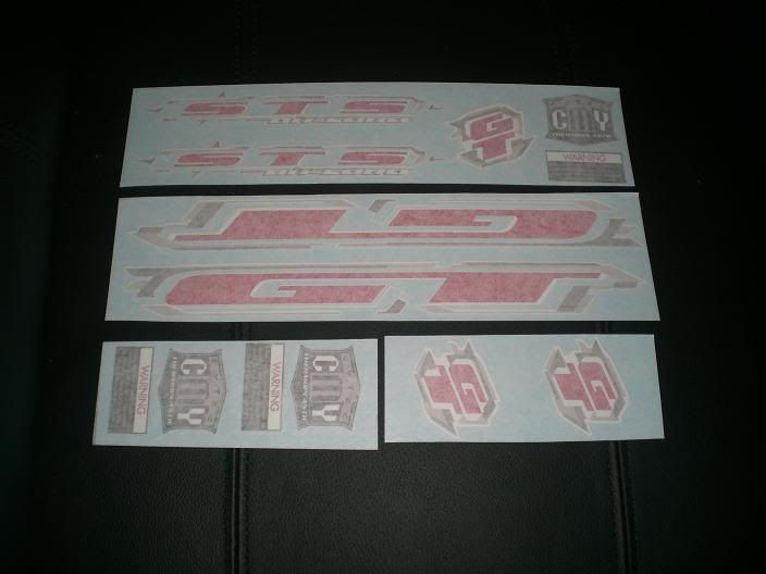

Gil_m can now do decals for the STS models, here's the ones he did for my Lobo

Ha, ha, yes ... so sad to sell it, but as seen in the pics, it was too big for me ( 19" ), the original I bought was an 18"; the one in the pics, was the only one in the Spain GT distributor to replace the cracked one, so, as they said: you can choose a Zaskar or a 19" STS ...

On the decals... I also have scans of originals, actually I have one original set at the moment... yellow and red I think?

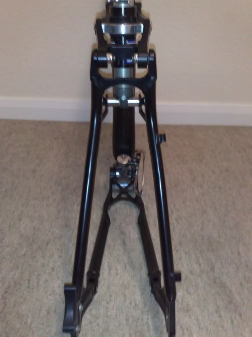

Just found a couple of what I think maybe an early STS rear suspension set-up. I think the bike may have been also still called the LTS at this stage. I could be completely mistaken and it's just simply a rear of an LTS-1 bolted on to a newer STS front frame. But it is sporting the non trunion mounted coil shock system.
