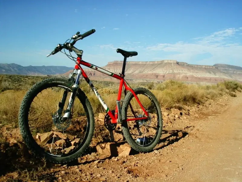

Good to see the old Bonty is going well, heres a picture of it in Utah on the Jem trail
As for the forks, Tim at Pace removed the air cartridge, which are renound for leaking and replaced it with a spring set, think he did it to a few of the early RC36's.
Basically there are no elastomers in there, just springs in both sides, they are easy to strip and service, just remove the cir-clips at the bottom of each leg and slide them apart. Probaly need a good service and if you don't feel confident, ring Pace and ask to speak to Tim, best be quick though :?
He also frequents this forum, so watch out he might even add to this post :D

Cheers Gil. Cracking photo 8)
