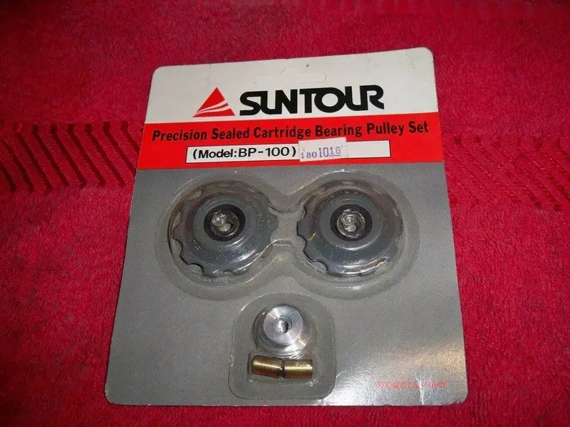

I am working on a 86 Suntour XC RD. I need to replace the jockey wheels and they are 10T. Does anybody know what would be a good replacement?Should any 10T work?
Thanks for the help

Thanks for the replys. I think the one in the picture would work but it is just a little different. I think I will try the Tacx pulleys. I can get them from my LBS.
