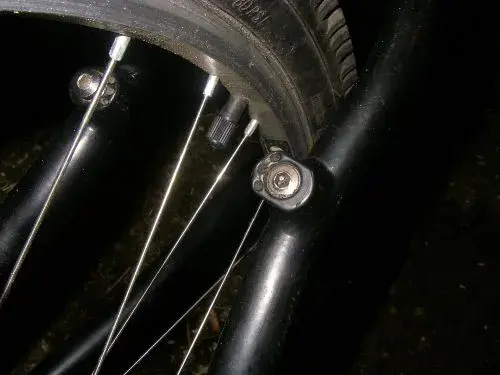

Hi Guys,
Can anyone tell me what type of brake will fit the rear of my bike please? I have had a few suggestions (Thanks) but am still struggling. The bike is a 1999 Rotwild CC02. I have been off the MTB scene for about 9 years and have forgotten so much :(
I have attached a photo.
Cheers!

Looks like standard canti mounts to me, but you'll need to get some posts obviously.

those are just blanking bolts aren't they? Can't you just remove them, put posts in (your LBS should have these) and put canti's/v-brakes in?

the bolts are not even matching , by the look of it
someone definately removed the posts
