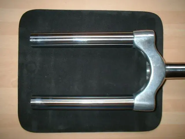

well to give you some idea , these are the 21 internals

Are you sure that this is a Q21R? Is it yellow?
The reason that I ask is that I've owned one and one thing I remember clearly is that the Quadra 21R had a stack of 6 small elastomers that the rider could swap out to "fine tune" the ride, instead of one long one. The Quadra 10 (gray) had one long elastomer.
Anyway... There was no way that I've ever remembered to swap out the internals to increase travel length. However, if you find parts from a long-travel Indy SL you may be able to swap out the stantion/steerer assembly and use the internals from that fork while keeping the lowers from yours.
Good luck!

these are from a quadra 10 , but the 21R i have is exactly the same
including one long elastomer
i am sure they just renamed them for the later years
the only difference being the adjusters , upgraded to an external knob instead of the alllen key slot

just checked the manual and it covers ......
93 quadra
94 quadra 10 and quadra 21
95 quadra 5 , quadra 21 and 21R
96 quadra 5 and quadra 21R
SO YES THEY ALL SHARE THE SAME INTERNALS ( MINOR VARIATIONS )
