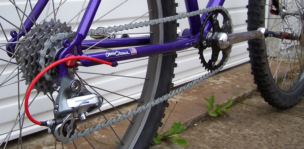

Not very good photo of my 1 x 9er. You all know I have been running SS for a while but I was getting bored with the lack of hill climbing ability. This seems a good compromise....in fact. I'm really enjoying it.
Get very :evil: sometimes when I run out of gears on a straight and get 'beaten' by a chinese tool ...but thats what the
