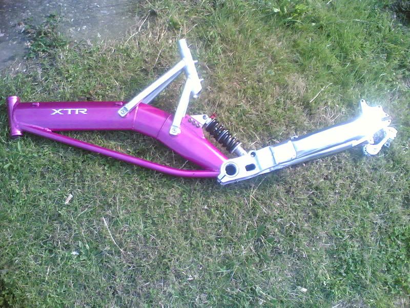

PostPosted: Fri Jan 12, 2007 9:02 pm
Joined: Tue Jun 06, 2006 1:08 pm
Posts: 962
Location: Mansfield, Notts
I found the polisher works a bit better than a drill though as instead of just spinning they kind of do a rotating action as well hard to explain, bit like whan you polish by hand in circles does that. Here's my results below although I've not finished the seat stays yet, oh and you'll be pleased to know I have now removed the rather naff looking XTR stickers though. Don't think I did too badly on the respray though, better than the boring blue it came in. lol
PostPosted: Fri Jan 12, 2007 9:06 pm
East Midlands AEC
East Midlands AEC
Joined: Thu Oct 05, 2006 7:45 pm
Posts: 15068
Location: Derby, UK
sorry to be ignorant - but what is that frame? It looks great!
